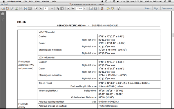

    I have all the specs from the FSM so I always just went by if my box was green then it was good lol

    I have no clue haha I've never worried about it that much.
    But here is what Autozone has on their page if that means anything to you.
    Caster:
    Range(degrees) - .75+ or -
    Preferred(degrees): .3
    Camber:
    Preferred(degrees) - 1.62
    Toe-in (Inches):
    +.06 to -.08
    Steering Axis Inclination(dec.):
    10.4
    Here were my specs last time I got an alignment. This is as close as they could get it because my adjustment nut between the tie rods on the passenger side is seized.
