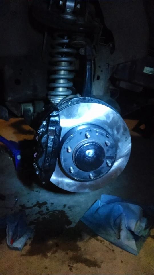

    Tundra brake swap.
    OEM rotors, pads, shim kit.
    Napa Eclipse calipers.
    New copper washers.
    Didn't bother cutting the dust shield. Just hammer the bitch back and fold over a part on the bottom so the calipers fit. Brakes are soooo sweet now.
