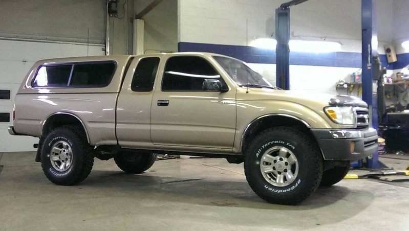

    With my 5100s from Wheelers still a week out, I decided to see if I can fit 33x10.5's without rubbing. So, how'd it go Peter? Not well. Not well at all...
    That was a 5pt maneuver to get out of my bay. :unamused:

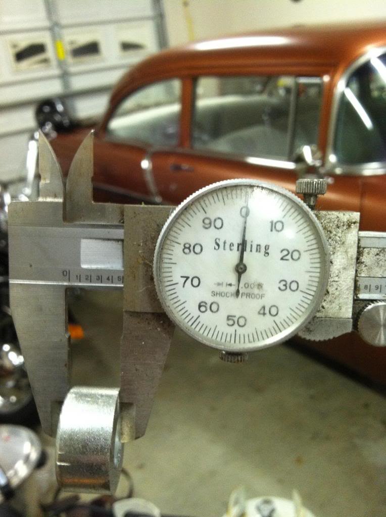

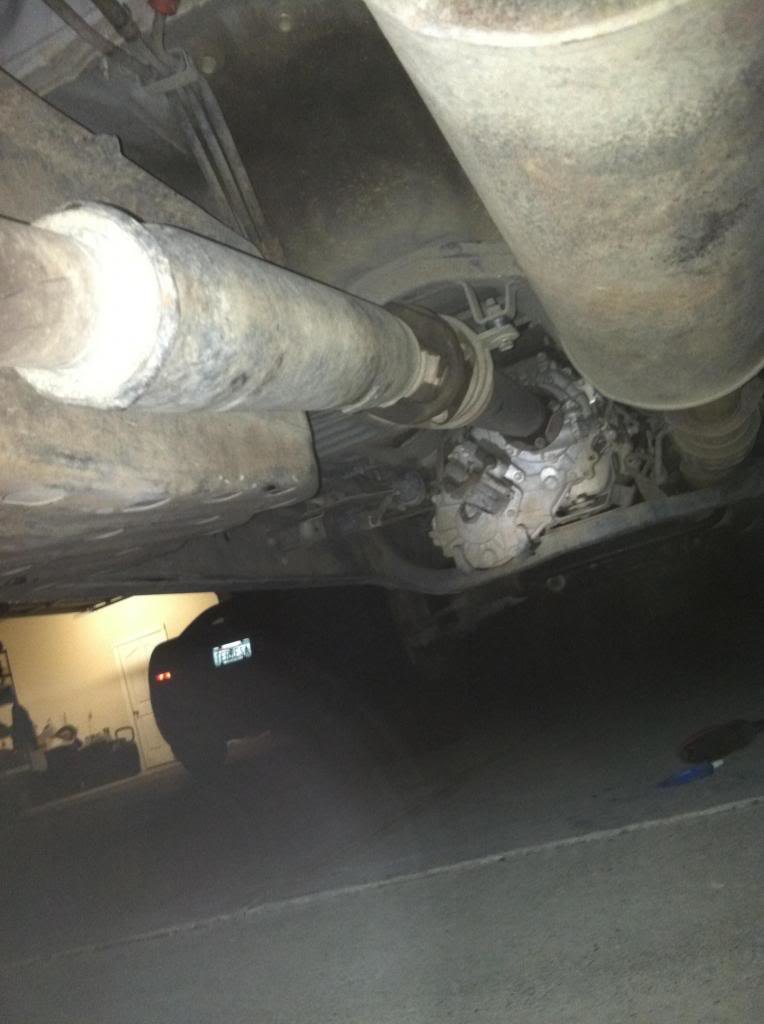

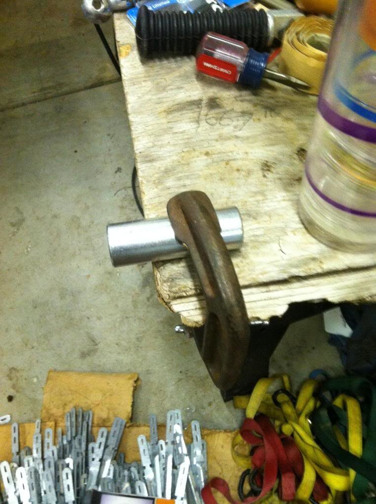

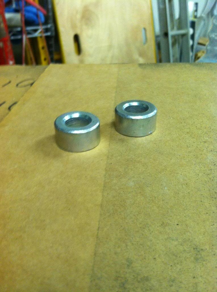

    I made my own half inch carrier bearing drop kit.
    it got rid of all the 70mph vibrations.

    With your amount of lift , you may want to go 3/4" on the CB spacer Mike...;)

    I should probably get a cb drop as well... The expos actually lined up the rear axle almost perfect. My cb angle, not so much... Haha

    Hey, thats what I use, perfect fit over the stock CB bolts, has worked flawlessly for 3 years...
    The only reason it'd possibly snap one of those bolts is if they were loose in the first place or possibly if there was too much slop between the shank of the bolt & your spacer of choice, still it'd have to be loose to begin with
    & I'd never use aluminum for any kind of spacer, especially where alot of weight &/or friction is taking place, the old Rough Country lifts from years ago used 3" & 4" aluminum blocks for the rear & I saw alot of them just melt away like a cube of butter on a warm plate because of the softer alloy against steel/cast iron
