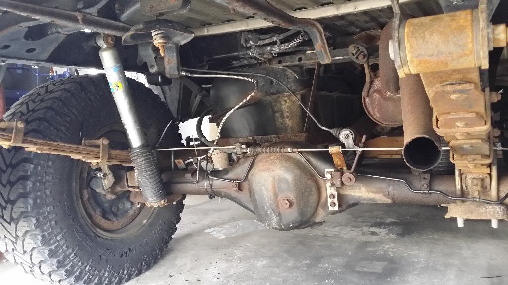

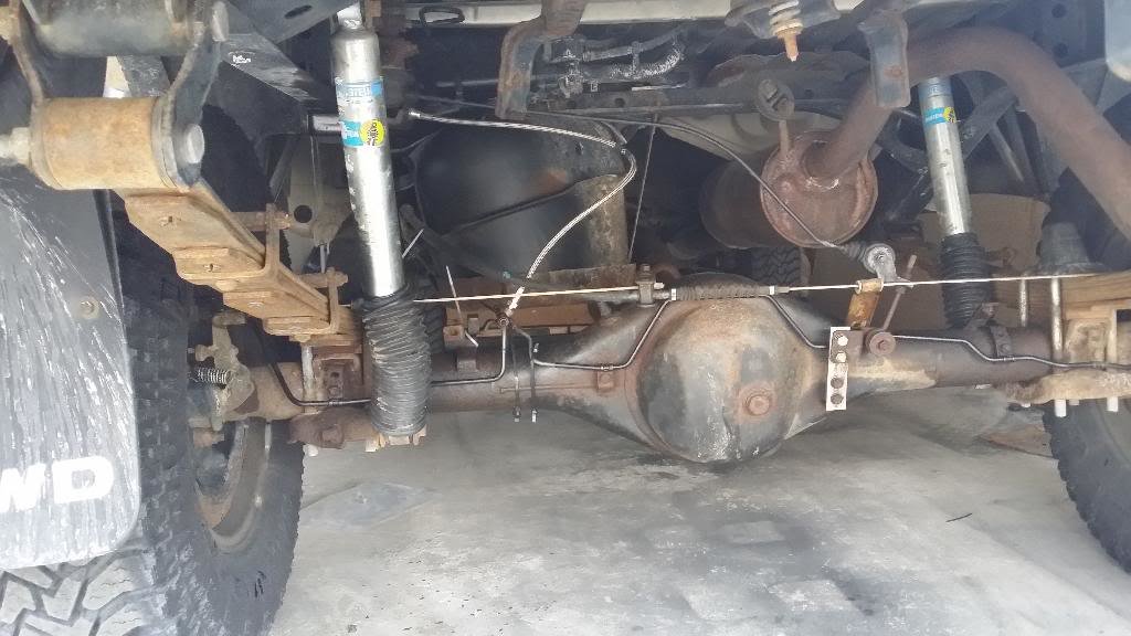

    Put some bling on last night, extended rear brake line. Anyone else have a problem with theirs rubbing through? A local said his rubbed through, but i'm not sure where or on what. Mine looks like it should be fine, but I haven't flexed the rear end with it yet. And yes, the little hard line junction thing is held on by zip ties. Rusty bolts ftl.

    Just curious but does it make any difference which way the bilsteins are mounted (boot up or down)?

    Nope. Most do boots down so you're not getting debris built up on the seal.

    What's the deal with one shock in front/one shock behind?

    Thats how all OEM setups are...haha
    But the idea is to help with axle warp.

    yeah, that's what i meant... the purpose behind it
