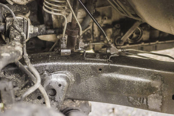

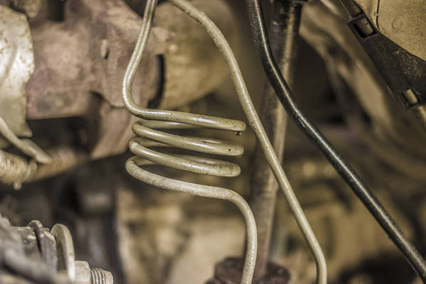

    followed it up and found this
    could this be a weld that broke loose on the break line?

    welds on a brake line? that doesn't sound right..

    Not a weld. More like friction wore down the line from coming in contact with the frame or whatever it's touching.

    I think you're right I got closer and checked it out looks like it just rubbed through the line. Thanks everyone.

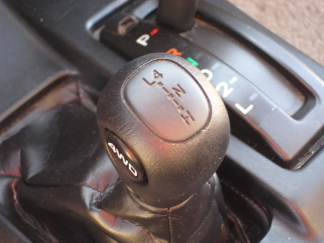

    Attempted to put my truck in 4Hi but when I press the button, no sound, no indicator light and it doesn't engage. 4Lo works just fine but that's it. Any ideas?

    Press what button? :confused:

    This one I'm assuming
    I don't know how they work though as mine is fully mechanical.

    He's a 98 and a 5-speed. I didn't think they made push button 4wd for those?
