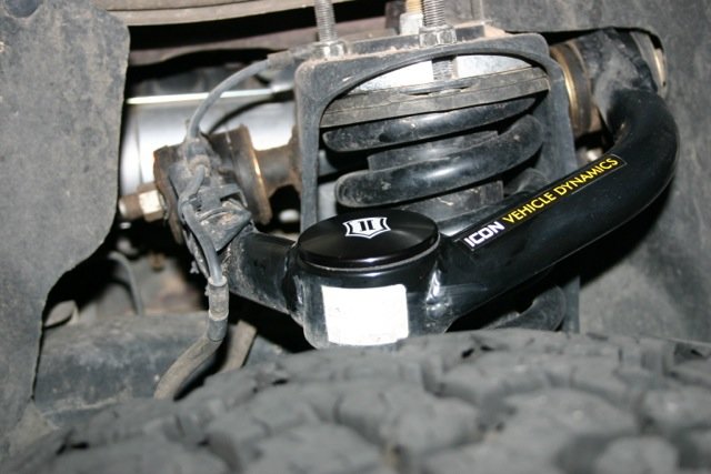

    Are those stuck on with the 3M adhesive ring? How do you lube the uni ball?

    Yes, you get 2 sets of adhesive rings so you can service the uniballs.

    I guess the dust covers do their job well because I have to lube my Camburgs about once a month to prevent squeaks.

    Having installed a set, I would not call them a "straight bolt-on" UCA. A couple of the ABQ TWers helped me at a friend's place that had a 20 ton shop press. We pressed the spindle to arm "coupler" into the top of the spindle. I could not imagine having used the bottom cup and the bolt to "press" the "coupler" into the top of the spindle. Would've required tonnes of leverage and something to hold it with. Everything else slipped into place. The only other complaint was lack of torque values.
    I will say, the instructions that came with them were for the 2nd Gen even though it pictured the 1st Gen hardware. Completely different setup and we had to do a little bit of thinking to get the job done.
    And, yes, the 1st Gen arms can be covered with the cover kit or possibly a neoprene boot. The top bolt has a nice low profile.
    My only concern would be the fact that the bottom is open but easy enough to rinse every so often. Gravity is your friend.

    Other than replacing a worn part, what are the advantages of these UCA's?

    Better alignment specs and travel.

    How much more travel can you get. Couple inches?

    Depends on your suspension really. Every setup will be slightly different.
