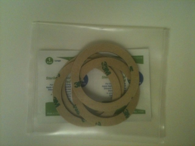

  19. Mar 25, 2014 at 9:20 PM
    Trigo
    Trigo Because fuck you that's why...
    Dec 21, 2011
    #69160
    7,053
    Rodrigo
    San Diego
    1st gen
    Watched it drive away for the last time, already regretting selling it but it needed to be done
    A little throwback of what she started as back in December of 2012
    Here's her replacement, 2011 DCLB 4x4
    Hoping to get into another 1st gen for strictly toy purposes after summer when funds recoupe
  20. Mar 25, 2014 at 9:21 PM
    tomtom
    tomtom Well-Known Member
    Jul 15, 2012
    #82706
    5,371
    The Desert SW
    2012 FJ
    Here's the adhesive ring kit:
    2 pairs and some alcohol swabs.
    Probably be just as good to use a thin bead of RTV and a whole lot cheaper. $15/kit was what they were when I ordered a couple extra.
