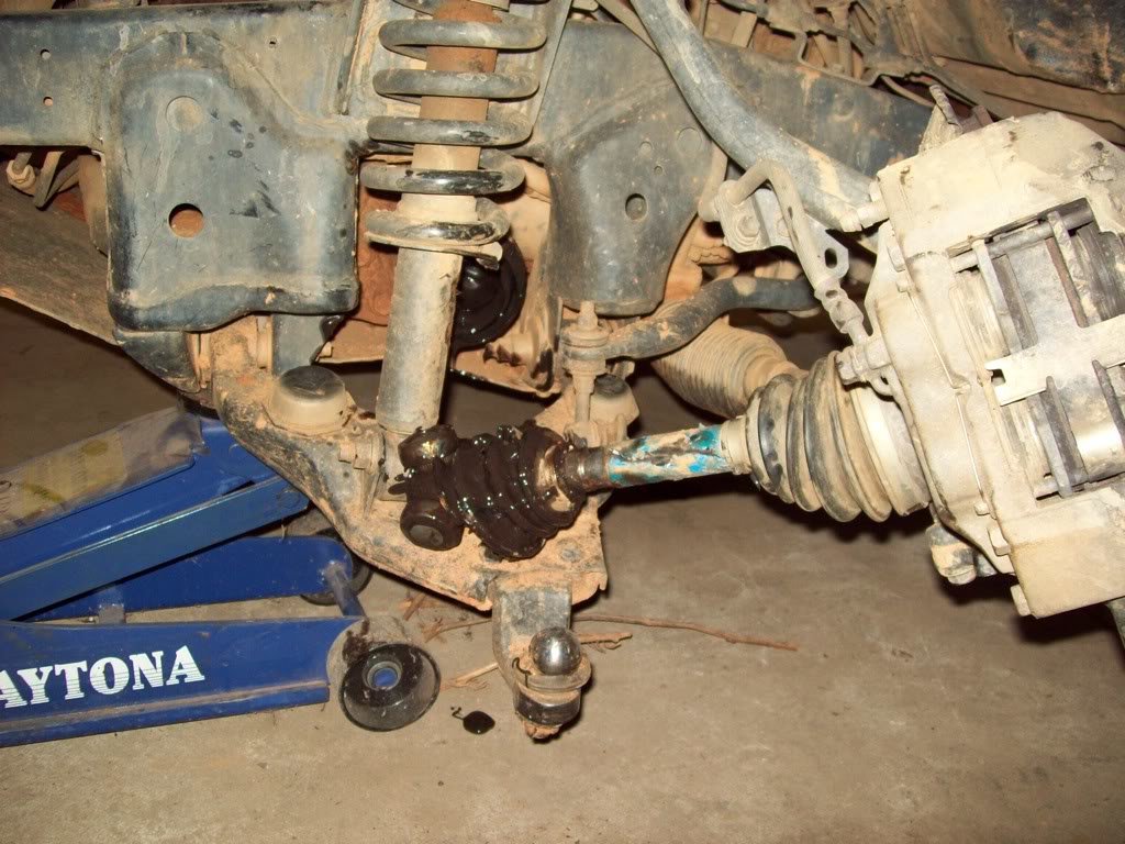

    SGT Taco noticed my ball joints were spitting grease. 125k miles on them. Out with the old, in with the new. Took me two days to do them, working on them 2 hours each day.
    I didn't screw around and ordered the OEM LBJ kits from Camelback Toyota. No issues on the install.

    Plus you should also be doing an inspection on your upper and lower ball joints anyways. In they are broke and spewing grease..you've got an issue. Fix it.
    Replacement ones often aren't as strong as OEM ones

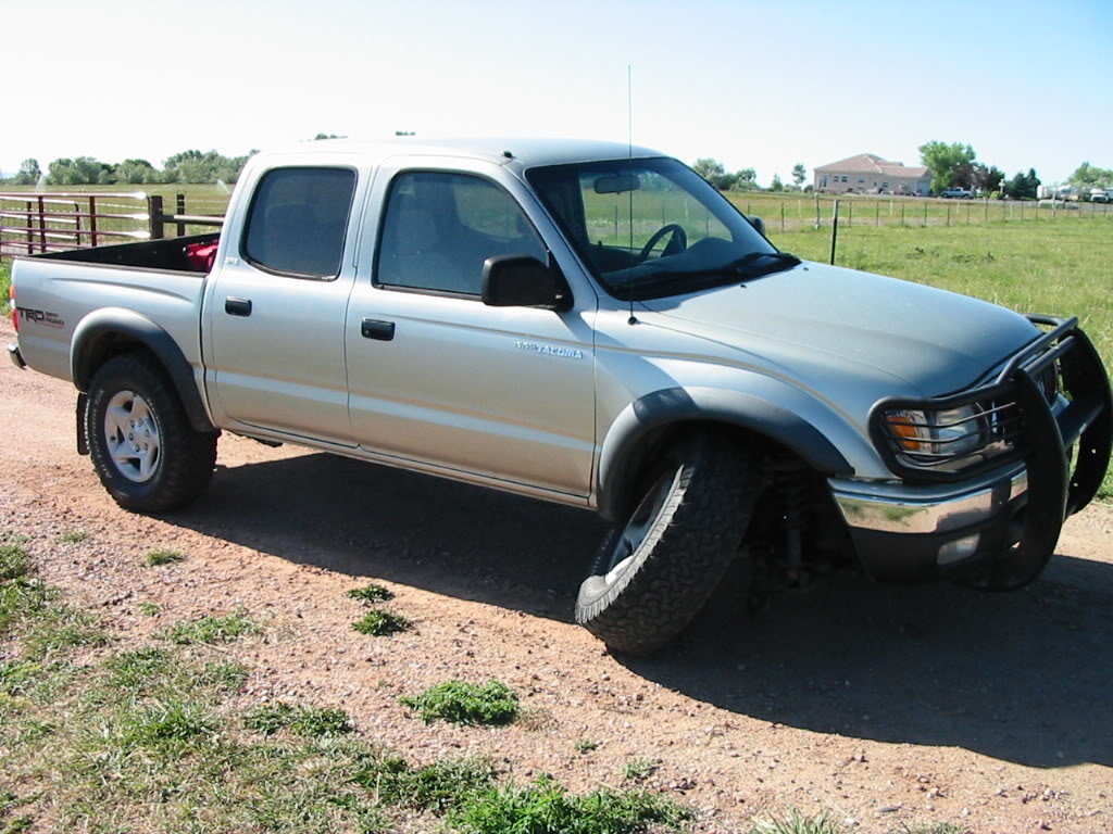

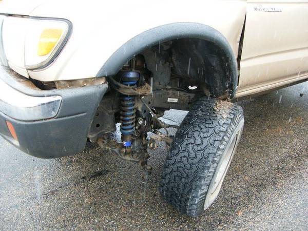

    There are just too many pictures of ball joint failures for it to be more likely that the bolts loosen and shear imo... :notsure:
  9. Mar 27, 2014 at 10:02 PM
    PcBuilder14
    PcBuilder14 Well-Known Member
    Jun 19, 2011
    #58522
    23,312
    Brent
    Nor Cal
    2018 Tacoma TRD Off Road 4x4
    Sheared bolts versus the spindle detached from the ball joint? Maybe I'm thinking incorrectly on what y'all are talking about...

    In my case I was goin to change lbj but couldn't get bolts loose so I pb blasted them and I'm wondering if they didn't vibrate loose after I hit it with pb blast cuz when mine happen I only had 2 bolts left

    I believe that is why there was a recall on certain LBJs. But almost all the ones I have seen, been a part of, read on here, have been bolts.
    Those are the first pics I have seen of the actual LBJ popping out.
