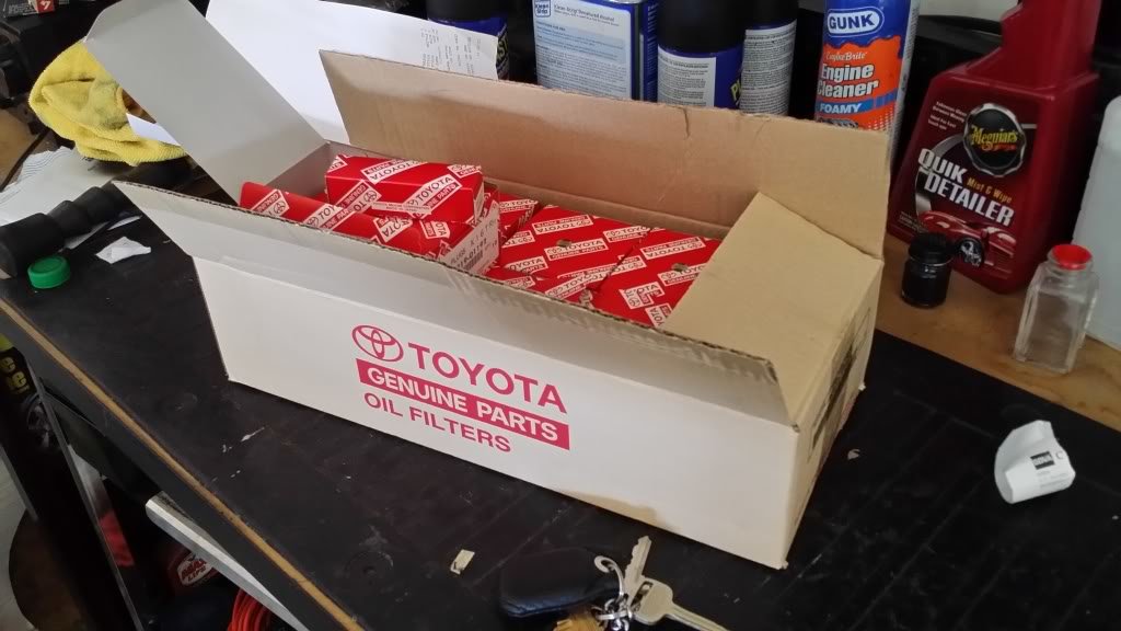

  15. Mar 31, 2014 at 3:26 PM
    yf19
    yf19 Well-Known Member
    Apr 21, 2013
    #102535
    261
    Phoenix AZ
    1998 ExtraCab Limited V6
    Icon coil overs, Camburg UCA, 1" body lift, lots of trimming, Scion XB seats with Wet Okle covers, Alpine Head unit and amps with RF subs and Polk Momo in doors, and much more.
    All set up for the next year or so, ten oil filters and a set of plugs from my friendly neighborhood stealer.
