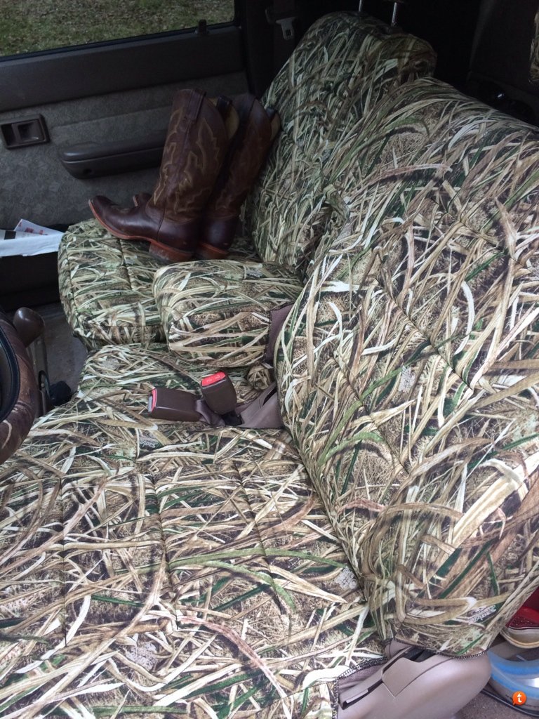

    Finally got my sportsman seat covers today
    Very nice people. Made in Ecru, MS.

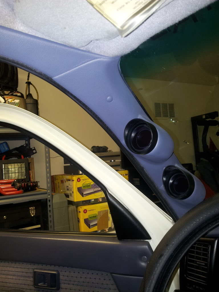

    Looks good man.
    If you want to paint it this is what I used http://www.amazon.com/gp/aw/d/B000BL39BK/ref=pd_aw_sims_2?pi=SS115 just find a model car paint that matches and spray it with that airbrush. It's much more controlled than the rattle can way

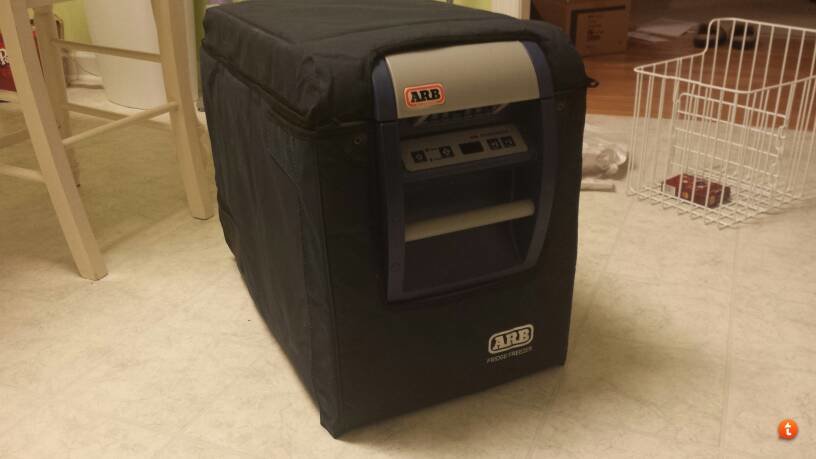

    Hooked up the arb 50qt with a cover. Got the crawl box installed. . Didn't snap pictures though

    someone spent some coin:)

    Yup.. This past year had emptied my wallet a bit. .
    Regear, front locker, rtt, fridge, 35s, bed rack, box rocket swingout, elite front bumper, crawl box... yeah its been an expensive year

    Where did you get the interior color match paint? I will be mounting mine soon and dont really care for the black color.
    Also, did you take your old column out or mount this on top and drill the screws into the column?

    I went to a hobby shop and got all the model car paints that I thought would closely match the interior and experimented until I found a dead on match. I have a 98-00 truck so your color will be different. I also used that airbrush from Amazon.
    Keep in mind there are two kinds of model paints, both are very durable for interior a pillar use... there is acrylic which is water based and enamel which is oil based and they can not be mixed together. I used enamel and used those little bottles of airbrush thinner to thin the paint. Hope this helps.
    As for the A pillar install, it's a Lo-Teck(?) A-pillar pod and I installed it over the existing plastic and drilled to the metal.
