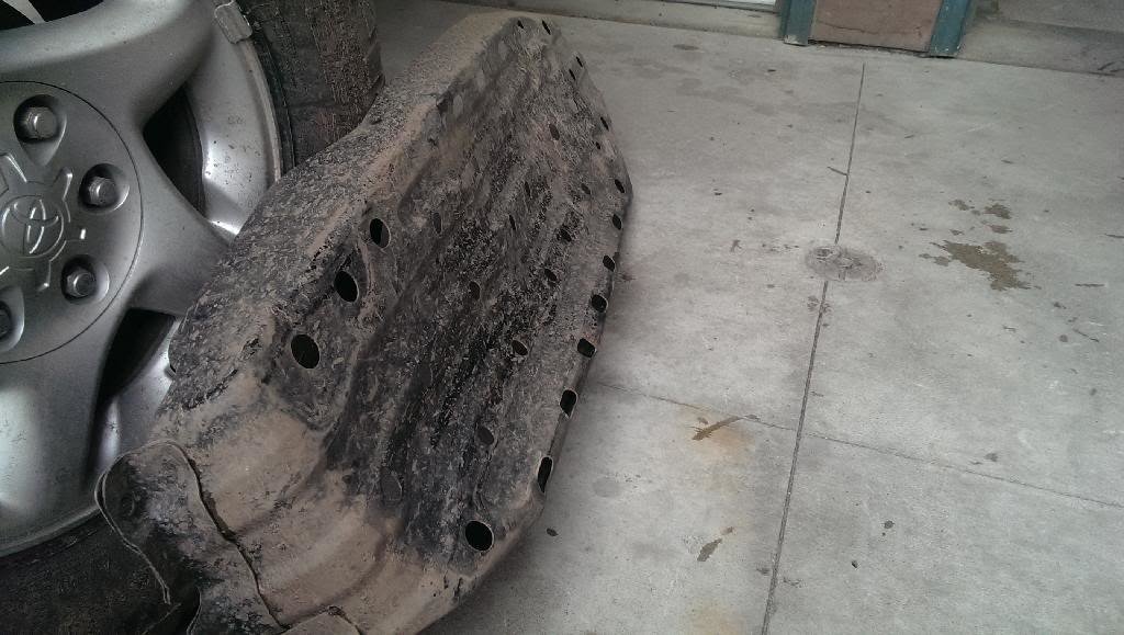

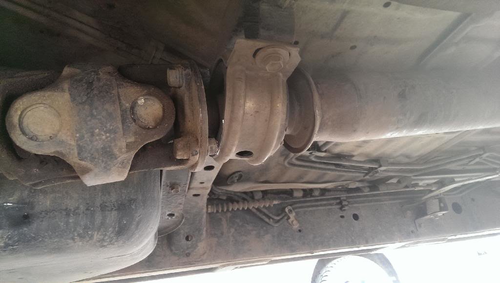

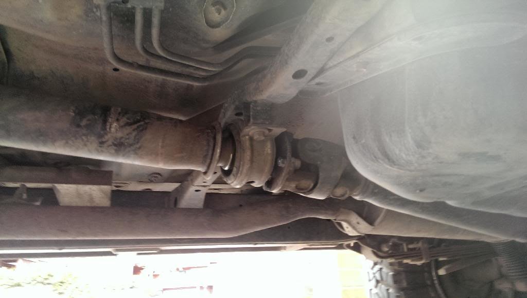

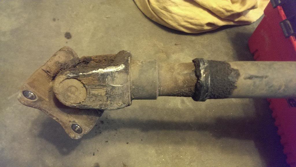

    Had an interesting adventure today:
    Got stuck in a creek:
    Didn't bother getting any better pics as I was franticlly trying to get it out.
    Found out what I got stuck on:
    And carrier bearing got smashed:
    Overall, not one of my better outings. Does anyone have any input on whether I can just replace the carrier bearing or if there may be other drive shaft issues. The angles looks kinda wierd, but the carrier bearing now has some extra play...

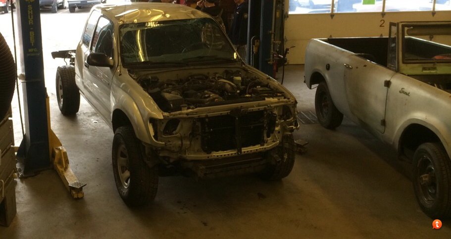

    Started my Cab swap!
    1500$ Rolled Taco with 100,000 less miles, no rust and a straight frame!

    Sure, you can replace the carrier, if thats all it is, & all carriers have what looks like excessive play...

    Thanks for the input. Carrier bearing appears to be destroyed, mount is bent to hell, but the drivershaft appears OK.

    check the u-joints for excessive play. Possibly take the driveshafts to a shop to spin them up and check for balance, etc. If you don't see any physical damage, new scratches and dents, they are probably fine. Just grease 'em up to force any yucky shit out.

    Don't you worry, there is indeed new scratches! Already pulled the entire drive shaft out to inspect it. Was thinking about replacing ujoints while I'm at it.
    But not seeing any dents.

    Have fun with the double cardon joints u joints. They can be a pain to work with. I found using a ball joint press really makes it alot easier and so much faster, even for regular single joints.
