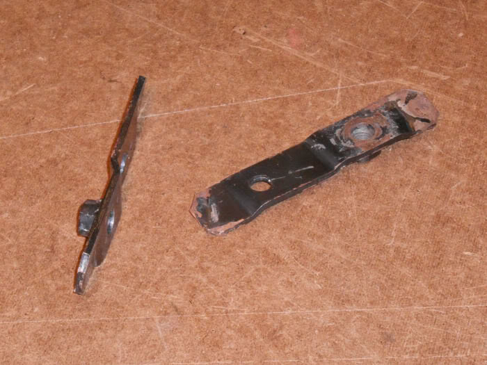

    Protruding fasteners on a skid plate are poor design. Counter sunk socket head screws are not much better. Folks have tried and failed at mounting skids since Tacoma day one. The stock mount points for a front skid are barley strong enough to support the weight of the skid alone. They are OK for the mall, not the crawl.
    OEM rear mount, from the factory lightly tack welded in place and consisting of just a strip of not even 1/8" sheet metal, with holes in it for that matter.

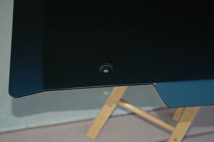

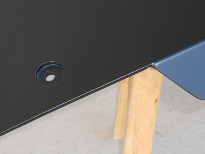

    Recessed mount. The wimpy week ass OEM weld nut strip was replaced with with 1/4" plate spanning and filling the U channel portion of the cross member with heavy flange nuts welded behind. Of course the ridiculously flimsy front mount was replaced with a real cross member. This has been standard procedure for IFS Tacos long before this forum came about. An additional benefit is the skid can be located right up against the cross member providing even more ground clearance than the stock skid foil.

    So true. I broke my drivers side skid mount 1st time I hit it. Very poorly made.
