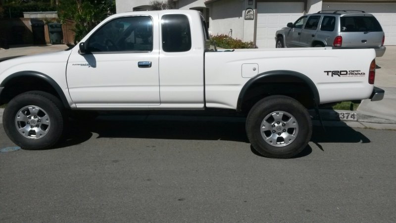

    I just put a procomp stiff AAL on the back and i love the feel of it (quick snappy tail whip action) but the front at full height on the 5100s sits too low and is way to divey on quick turns.. it just doesnt feel right, doesnt sit right, doesnt look right..
    here how it looks now: with the 2in AAl and the front set at max height on the 5100s.

    i actually have a diff drop kit but its not installed yet.. as you can see with the pic i posted above it sits 2 inches higher in back than in front(measured at wheel well).. i dont think i got much more than an inch when i set the front at full height on the 5100s :/ maybe my springs are shot? Also I do go pretty hard on my truck but i dont want to drop 500+ on coilovers, so some coil springs with increased spring rate is what im looking for.
