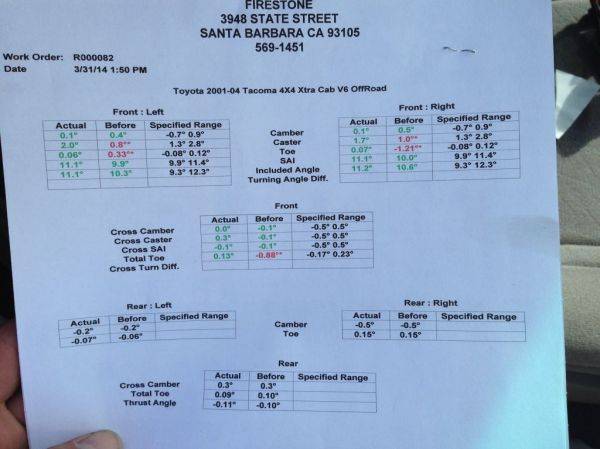

    do u have ucas? if so im willing to bet you could bring that camber more towards the center and increase the caster quite bit. basically u want to get the most cast u can without sacrificing camber too much... i like even tire wear, tires arent cheap. so my camber is perfect, my caster is a touch higher than spec. drives fine.
    with a truck like jasons, hell yeah sacrifice camber a bit to get as much caster as u can. when hes haulin ass and flyin over bumps(mtns to me) the more caster keeps his bump steer down and allows him to more accurately feel what the truck is doing.

    Ive got LR UCAs the biggest problem is no one wants to align lifted trucks around here.

    thats shitty. with lr ucas, you could get up to 4* caster if u wanted! i doubt u need that much but those being adjustable give u lots of options... around 2-3 is perferred
    depends on which ones are maxed out? thats not a bad alignment u have there^

    i have the plates set to 0, so i could adjust them and then take it back in, but i have good tire wear, and it drives straight right now so im good. and plus my tire is already rubbing on the front of the fender well

    ok so since you have diagonal eccentrics both maxed, then yes thats as good as your alingment gets. hard to explain without showing u on a machine, but the front eccentrics move camber/caster >up/up or down/down. the rear eccentrics move camber/caster >up/down or down/up. so when u have opposite sides front and back maxed, then the alingment cant move for the better much before it gets really far away from the other side.
    like i said hard to explain. if i was u i would rock it like that for some time. its not a bad alignment. but u may have some tweaked lcas....
    see i charge a little more when i have to adjust the lr uca plates. a good alignment tech should know if he needs to adjust the top plates or

    yeah im willing to bet u bave one or both tweaked lcas...... i wouldnt replace them until the aingment really gets messed up

    why are you guys running such little caster? i've always set them up to run about 5-7 degrees at ride height.

    when u lift the fornt of the truckis there play when pushing and pulling on the lca? also if u look up and in towards the bushings, are there really bad cracks in the rubber?
    on a 4wd taco? how r u accomplishing 5-7 degrees of caster?

    Firestone can suck a cock. The techs there are complete nitwits. I basically stood in the alignment bay and told the cum guzzler which way to turn each eccentric to get the alignment I asked for. They actually refunded my lifetime alignment after 5 or 6 times of fucking it up.
    My bet is the mounts over the LCA. The LCA is actually pretty stout...the lower mounts, not so much. All of mine are tweaked/bent to some degree.

    i dont think so at all... ive replaced numerous lcas and alignments came back into spec. and im still confused on how to get 5-7 degrees of caster on a 4x4 taco. i dont see it happening without lr ucas on astock truck n lift. lol which would be stupid... would be hell trying to turn into a parking spot, and tire scrub would be fubar'd. my .02 of course.

    Before I tweaked my frame I was at 5.5 at ride height.
    And again...it's a trade off. I'd rather have the faster return to center and at-speed stability than care about effort to turn into a mall parking spot.
