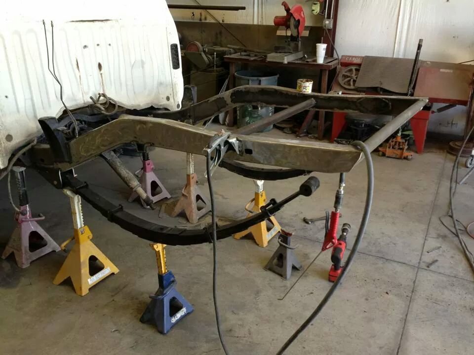

    Took my truck to a local shop called one stop and they finished up reinforcing the frame and fully boxing it and cleaning the frame up. Also got front hangers mounted for deavers

    Frame boxing looks great. Which Deavers? F67 or E30?

    that^ sure makes the frame look beefy.... how far under the cab is recommended to box when doing that?

    You don't need to box under the cab. The frame is boxed from the factory all the way to the front bed supports. After that it's C channel to the tail. Right after the forward bed supports there's the factory crossmember that supports the gas tank.
    I was lazy and just did the TG box kit because I would have had to cut my bedcage out to plate that area and replace the crossmember. The TG kit starts just passed the crossmember and runs almost all the way back.

    learn something new everyday.... i wonder if doing the reinforcement plates like i did have helped me keep my frame straight? guess it cant hurt, thats why i did it....

    They totally help, especially with deflection outwards on a hard hit.
    Frame plates are a good compromise. They are A HELL of a lot easier to do than boxing the frame and will satisfy most people's needs.
    Desert trucks...boxing for sure. I started with just frame plates and boxed later down the road.

    ok so these boxing kits. is it as simple as cleaning it up real good and making sure you are melting both the plate and the frame together? doesnt seem too dificult of a welding job? i mean obviously after u remove the bed and all the b.s. wiring and brake lines and shit

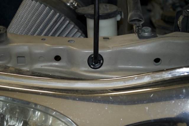

    Replaced the prop rod grommet:

    This kind of mod belongs in my build thread.
    For real though... I need to replace mine as well

    Part number 90480-15028, list price is $2.53. Got it from Camelback for $1.82.
