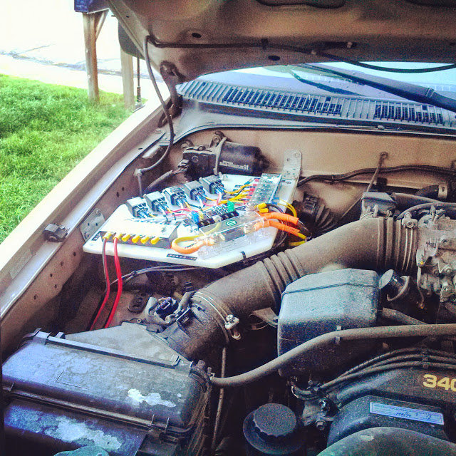

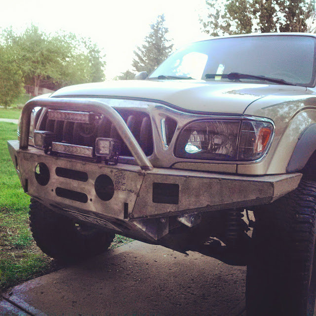

    This was yesterday. So it entirely doesn't count.
    Relentless GB DIY kit came last week, tacked it together yesterday and then moved on to wiring up my relay/fuse board that I've been putting off until I had somewhere to hang my lights. The mounting holes on the lower light are slightly off-center, which must change, and the pods aren't aimed yet. But the two 10" bars are wired with each other, so much light.
    Relay panel installed. I'll rework my wiring organization into the cab when I add more lights and when I get new Carling switches that I can wire up to the dash circuit. I also plan on having the forward-facing lights have a master shutoff by tapping a signal wire into the high beam signal, and have that control a relay that independently powers the switches for the front lights.
    Sorry for the shitty pictures. Too lazy now to get the real camera out. Instagram is the easiest way to brighten camera phone pics.

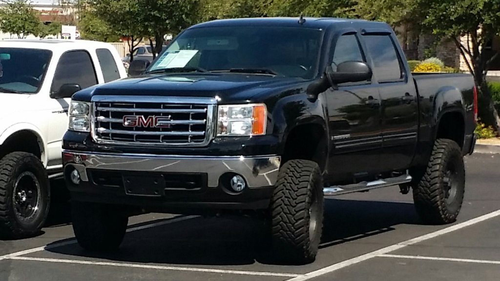

    Thinking of getting my new mod. Hope the brakes and steering work :p

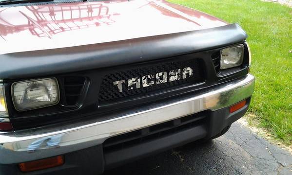

    Finished my Satoshi grille.

    YES. I'm hoping to make the same mod this year too, but that also means bye bye Tacoma

    Exact mod I'm doing after graduation except it'll be a dmax

    I plan on keeping the Tacoma because it has so many miles on it 480,000 and counting.
