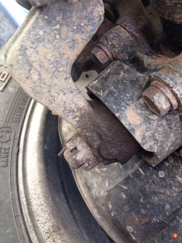

    This is a pic I just took, there the same
    On both sides, if they are going bad they would make A popping clicking sound when going over speed bumps or turning sharp?

    The boots are blown either way, they should be replaced.
    Even if they are bad, they may not make any noise.

    By the time ball joints start popping, they don't have much life left. I would make that a priority repair.

    So from that picture you guys think the lowers are shot? I checked out the tie rods but I can't see any tears or anything but I'm not sure what to look for I'm new to all this hanks for the help guys.

    Yes...
    Again, if the boots on the lower ball joints are blown like yours are then they should be replaced as you are losing the grease and letting contaminants in.

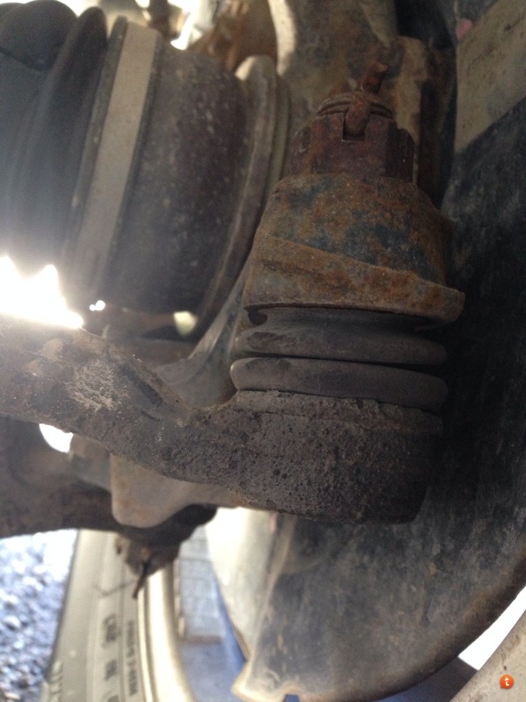

    Outer tie rod end
    Boot looked like it had alittle grease on the bottom uzezamud_c91be14a74b741fc6d47bc8857f71450fe1281c9.jpg
  16. May 26, 2014 at 9:02 AM
    tomtom
    tomtom Well-Known Member
    Jul 15, 2012
    #82706
    5,371
    The Desert SW
    2012 FJ
    The darker colour right underneath the dust shield area is indicative of the boot blowing and grease leaking out.
    OTREs last longer because they are not a load bearing part but typically people replace them all together since they have them apart.
    Autozone sells a pitman arm puller that is the perfect size for the LBJ. http://www.autozone.com/autozone/ac...rm-puller/_/N-264w?itemIdentifier=555623_0_0_
    They have a smaller one that is perfect for the OTRE. http://www.autozone.com/autozone/accessories/OEM-Tie-rod-puller/_/N-264w?itemIdentifier=555631_0_0_
    Put some torque on 'em and if they don't pop, whack the knuckle with hammer.

    I've watched their tie rod and ball joint video countless times haha
    Just be sure to have a ball joint/tie rod puller... I'd rather use this method than taking a hammer to the spindle.
    "Ball joint" boot looks good.
    Is that grease on the bellow coming from your cv or leaking of of the steering rack? If it's leaking out of the steering rack, it means the seals are going out on the rack.
    Also, jack up one tire at a time and try to turn the tire by hand to see if you have any play in the tie rod/steering.
