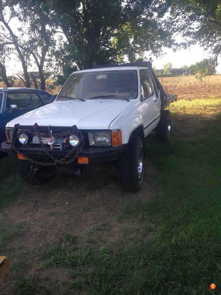

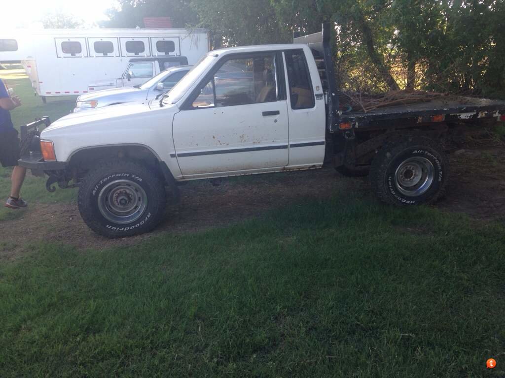

    Found this nice truck out at a friends farm in Wichita ks

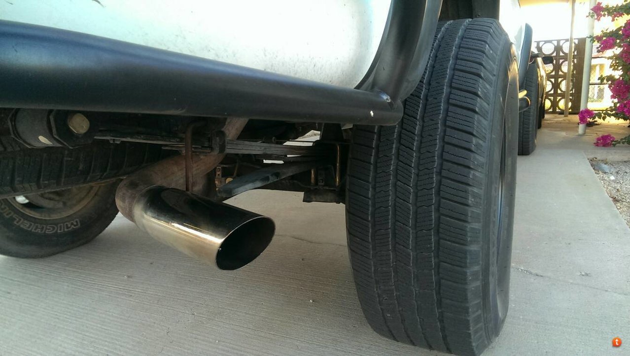

    Installed a jba catback exhaust. Thanks again juantaco for the good deal and help with install! 4yqyqemy_0a5bbb9ceb0769ee6d8b3d566ed8a07d64d27f0b.jpg

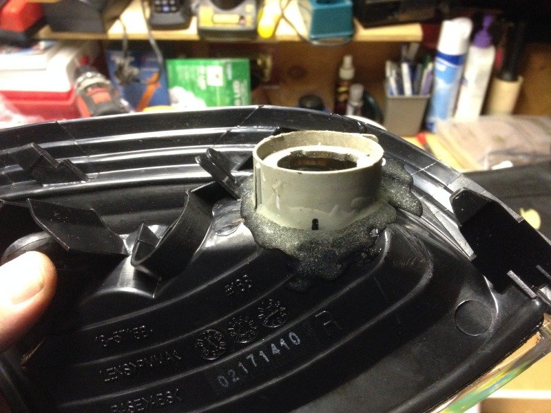

    Relocated my blinkers today. Had a problem with my epoxy not curing but bough a new batch and got it going.

    How do did this whole operation go? Pretty time consuming?

    I recently did mine similar to blackdawgs, went super easy, I took my time, maybe an hour per side.

    One thing I would suggest is use a fast set epoxy to hold it in place and then fill in any gaps with silicone. The problem I ran into was because of the size of the bulb you have limited space to mount it, and it's not flat so there will be gaps.

    Dremeling the bulb socket to contour to the housing took the longest. I'd say an hour per side counting epoxy curing. And yes definitely go get some fast set 5 minute epoxy. Worked great. I didn't add silicone because I spent time trimming it to contour pretty damn tight.

    That would make it easier but i just wanted to finish them so I filled any gaps:D

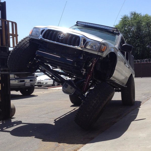

    Finally was able to flex it out about 3/4 way since getting the flat pitman arm in and notching the frame
    Also got the test radiator in out of a 22r because the 2.7 radiator was still to big for my setup for some odd reason.. Actually seemed to run cooler than normal..
    I still have 2 2.7 radiators, one is brand new and went it for a day but was never run if anyone is in need of one! and the other is used and has a small leak I was told but unsure for myself.
