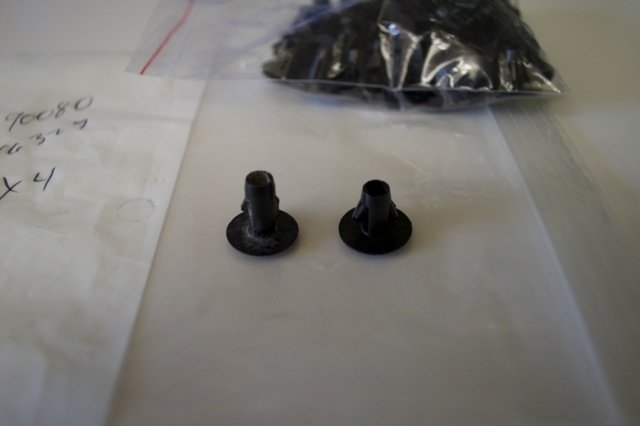

    Couldn't find 1st Gen engine apron fasteners for cheap so ordered some 2nd Gen engine ones off of Ebay hoping they will work in place of the 1st Gen ones.
    1st Gen Part No. - 90080-46327
    2nd Gen Part No. - 90467-10107
    Testing later tonight but looks like they should work. Stem is a little shorter but same diameter and the head and latch look to be the same. Then I can get my new engine aprons done up.

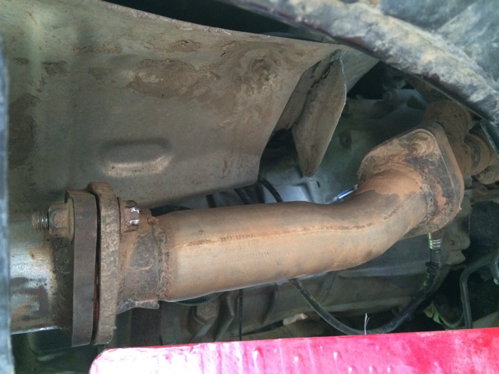

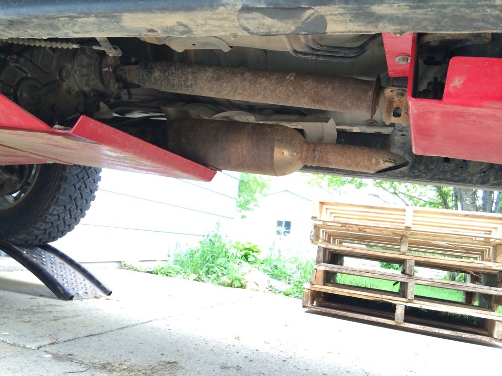

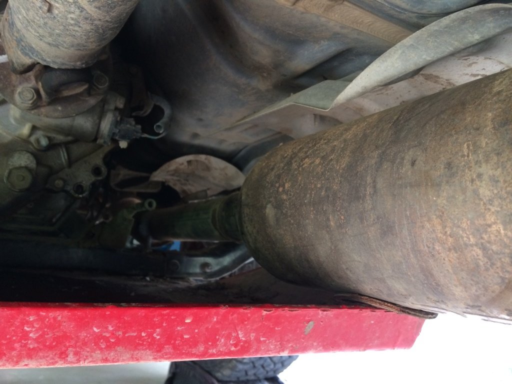

    Finally took some pictures of my new exhaust setup. All I had to do was remove my rear cat and bolt the "cat back" to the front cat delete pipe. I didn't need another delete pipe, which was convenient. Trd headers and aero turbine 2525xl if you didn't know.

    Where did the cat delete pipe come from or is it part of the trd header kit.

    Let me know if they work cause I need some new ones

    It's custom. When you buy headers you have to cut your front cat and weld on a flange, so the pipe was made in lieu of that.

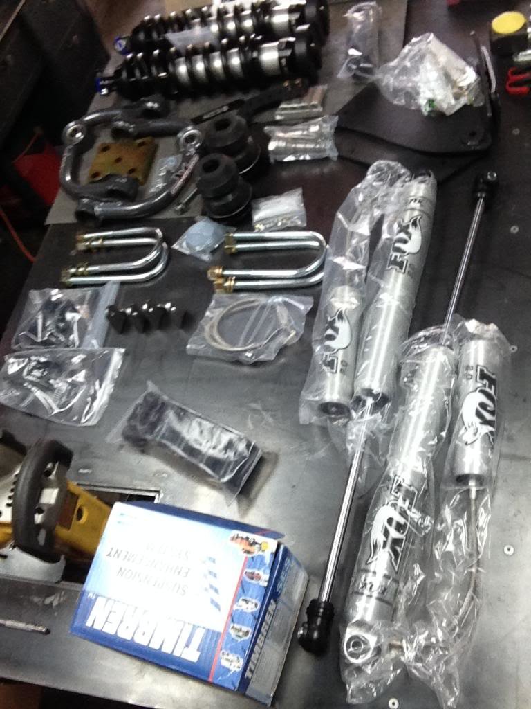

    997B5966-27F7-49AE-90FA-740D0EECD5C5_547a13f6fc2da9f9499ebd92f90f161574aff45c.jpg + expos, happening this weekend

    Thought you where doing a 3 link setup?

    No I cashed out what I had invested in that idea a while ago.
    My future was going to change but it's not anymore so now I'm back on the truck.
    Staying ifs for now...
