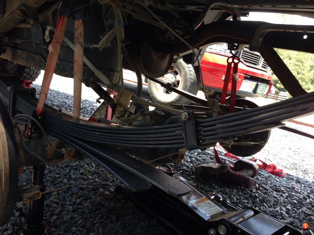

    Ratchet straps and bottle jacks make it a one man job :)

    It worked perfectly. If I was on a smooth garage floor, I probably would have just tried to push the axle forward, but I think I'll always use ratchet straps like this in the future!

    I'm gonna violate the "all by myself" job in a few minutes when my wife helps me to manipulate the pax side spring in place for the first bolt. ;)

    yea it was pretty easy to slide the axle forward on the jack stands on my garage floor. i only used a ratchet strap to support the axle from falling out of the drive shaft.
    Eh. Sometimes you just need an extra hand for a second. Id still consider it being done basically by yourself :cool: lol.

    All done. Momma helped for a total of 1 min, just enough to help me thread the pax side spring over the wheel and the rear end above the tail pipe. ;)
    The rear axle definitely gets moved fwd a bit...
    But it moves back when compressed...

    Can you post a picture of your shackle angle? it looks horrible, i dont think it should be vertical at ride height.
    also im curious why it moved forward so much...
    you didnt, when you ordered it by any chance, accidentially get a pack for 95-97? they are 2" shorter

    Talk to Cruiser Outfitters and got a message from Box Rocket that this is what to expect...

    Dakars I'm assuming. My shackles looked the same way when I installed them. After a day of driving the spring settled and the shackles moved to a more natural angle.

    My axle didn't move forward that much. What coils did you go with.

    I would invest in some longer shackles

    Dakars w/ D6XL AAL. The CBI Bushmaster with tire carrier should arrive any day now, and will help ;)
