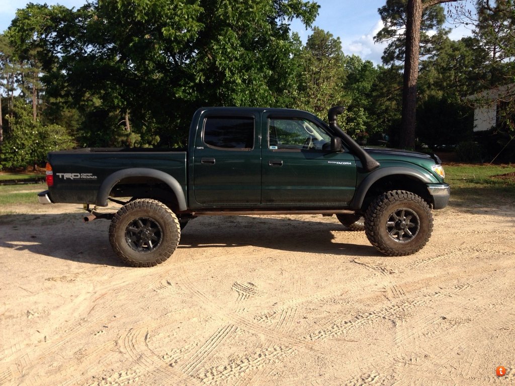

    This looks really nice! Gj! I'll try and get back to look at what you've done but... Looks like an 1.5 shackle and new leaf pack. Ome with aal? Or expos?

    Time to cut that tail pipe down :)
    Edit. Looks like you'll be moving the axle back too at some point. I need to, and a bunch of other peeps too. Cutting works alright as a bandaid!

    The Magnaflow catback kit reroutes between the frame and spring pack. Another way to solve the problem. Let me know if you want a pic.

    those are the ome shackles i believe.... i have 6 inch eye to eye tg shackles and my shackle angle isnt the best either....
    his springs need to break in and itll be better
    as for the axle moving foward.... normal with dakars. hence why Adam and i both used relocation plates to shift it back

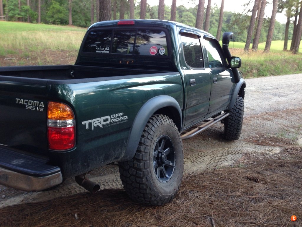

    just out of curiosity. What would be the purpose of putting your axle back to its original position(with relocation plates)?

    to place the axle back in the center of the wheel well. i used to rub on the front of the bed. no no rubbing at all, all the way to bump

    The tire sits too far forward and rubs in the wheel well.

    So basically if i don't rub then i don't need em. Guess i will probably need them when i go up to 33's
    Thanks guys. Always been curious if there was another reason or if it was just to prevent rub.

    If you still have the mounting flange aft of the last cat, it will still bolt up. It is a full-up cat-back kit. Replaces the piping and the muffler from the rear of the cat to the exhaust tip. Magnaflow Part No. 15811 for the V6.
