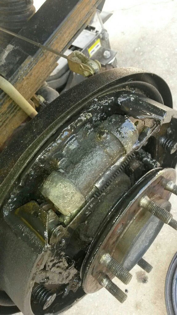

    Looks like its time fot new axle seals on the rear end. Anything else I should replace while im in there9yqe8yje_abba28d86ee66d38fa31b62ef2cd2d868ef891d4.jpg

    Everything. Seals, brakes, service/replace bell cranks.

    as far as seals go all i need is the inner axle seal and o-ring, correct?

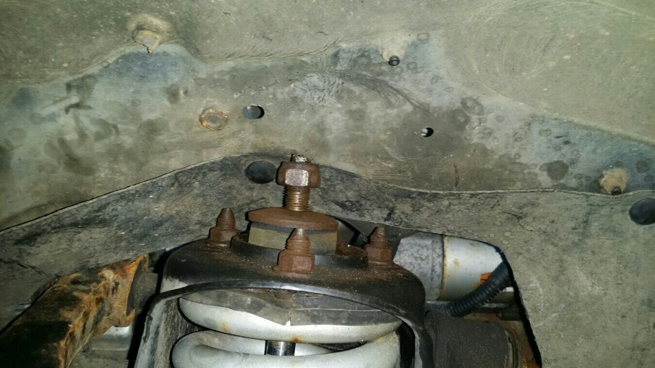

    Haha tried that yesterday since I was doing lbjs. Now the shaft nut is stuck with probably 2 threads left. Damn rust. vuba6y6a_2cfd9f3697d1ede0eb09f3f91aabd30074e9859c.jpg

    Check the bearings and races too. What o-ring?

    o-ring talked about in this write up.

    inner seals, outer seals, o ring, bearings, clips. the bearings are trashed, all the grease has been washed out by the gear lube. rear shoes obviously too. gotta press the bearing/backing plate and abs retainer(if u have abs) and spacers.
    if u dont have a press. take out both axles and bring them to someone who does. we charge only an hour per axle. alot cheaper if u do it that way. dont bring it to someone whos never done it. they will mess it up..... i fix small shops mistakes all the time. you have to pay close attention to where the spacers sit....

    Crap, what happens if I check the bearings and they are good?

    Yup if you're doin the whole hub, it's going to be around 200 with parts an labor.
    At least in pretty sure that's what mine was.
    Should he just replace that inner seal and see if it's that or are you sure te bearing is toast?
    I'm pretty sure I went through the whole bearing replacement and I didn't really need to

    Im really hoping the bearing is good because I dont have the spare cash to do it right now. But I will have a spare car available to me all week and my friend has a shop and said he would let me use his press when I asked him months ago when I was inquiring about a rear disc swap.
