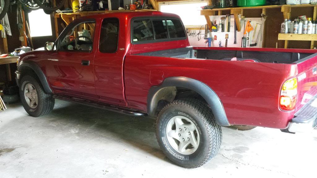

    And so it begins...
    Before Pic:

    Thanks!
    Did your kit come with any tapered shims for the rear leaf spring perch?

    I have a pair of 2 degree shims, I'll bring just in case. You may or may not need them, every lift seems a bit different in that respect.
    I ended up using 4 degree shims and dropping the CB 1/2"
    This is to align the driveshaft with the pinion and prevent vibrations.

    I am frickin pissed...as in filing a MN AG Fraud Complaint pissed.
    When I bought this in March, the Toyota Dealer sold it to me as (they) replaced the frame on the vehicle.
    Last week, I found that they had tack welded a nut to where the top plate stud should go. Today, while trying to install the new suspension, I found a second nut welded to the top plate stud. Only this time they welded the nut to the stud AND welded the nut to the frame support.
    Stay tuned for now...
