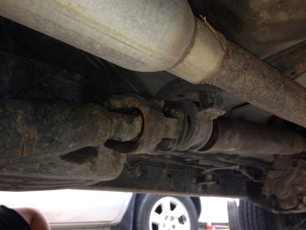

    Need to see the end where it goes into the rear axle. Your looking for it to be as straight as possible on the axle end.

    Found the problem
    The u bolts were tilted towardthe front of the truck throwing off the driveline ange causing vibrations

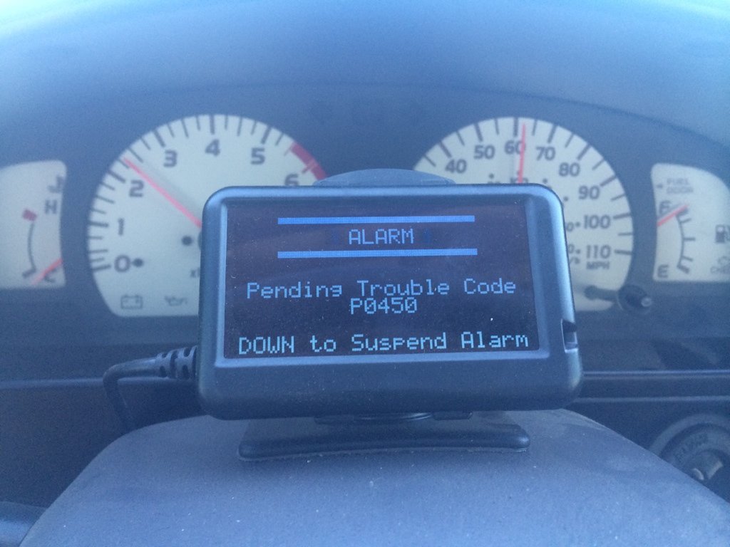

    Got this while driving to work this morning. It never actually triggered the CEL, and it hasn't come back. I'm thinking it's a fluke and had something to do with the heavy rain yesterday.

    Or your gas cap just wasn't tight? :notsure:

    Never messed with the cap and I drove 20 miles after I gassed up yesterday without issue.
