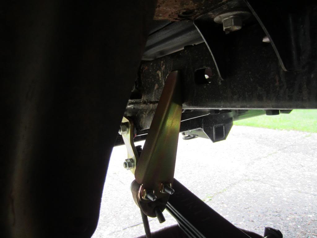

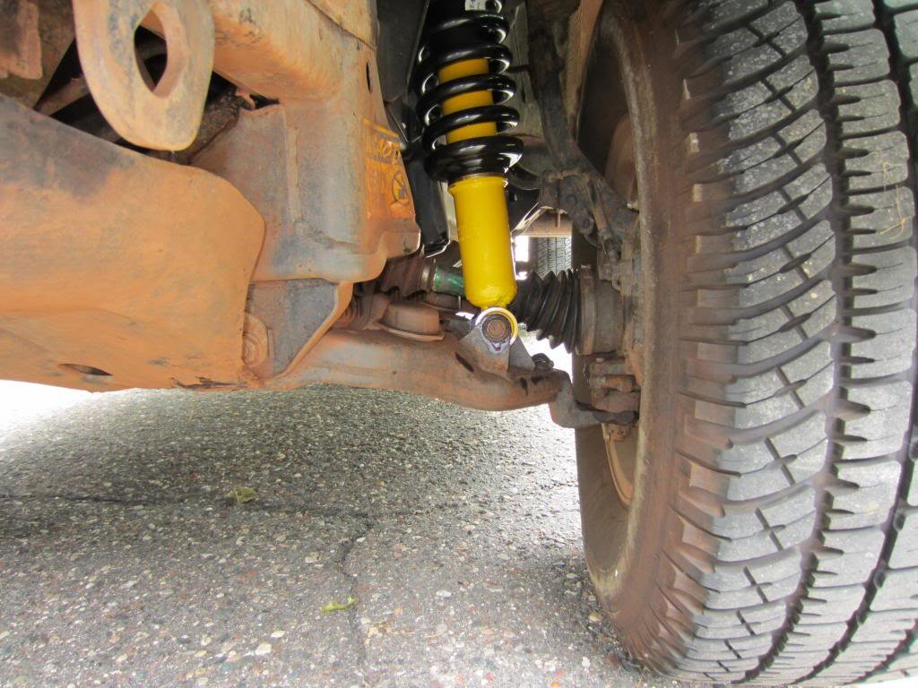

    Here are some more pics of the OME install yesterday. I get some trail pics this weekend. Once I drive it around a little, I'll also retorque everything. I'm also not running the swaybar.
    Front Shafts. Angle isn't too bad but I do have a diff drop kit that I'll get around to installing.
    Drivers side rear. The brake line and breather extension are plenty long. The greasable shackles are nearly vertical so there should be plenty of flex too.

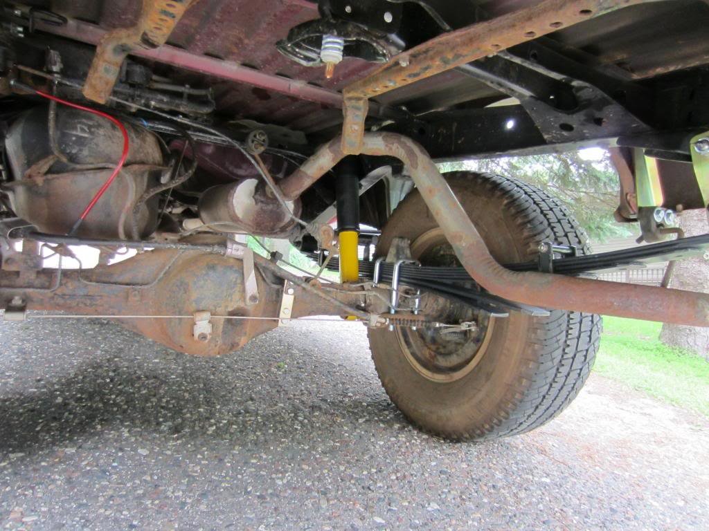

    Passenger rear. The BPV bracket works reasonable well as the control arm is nearly parallel to the road. Also, though it looks like it in the pic, the exhaust does not hit the leaf. If it does, however, I'll just cut the exhaust back.
    Better pic of the exhaust bracket.

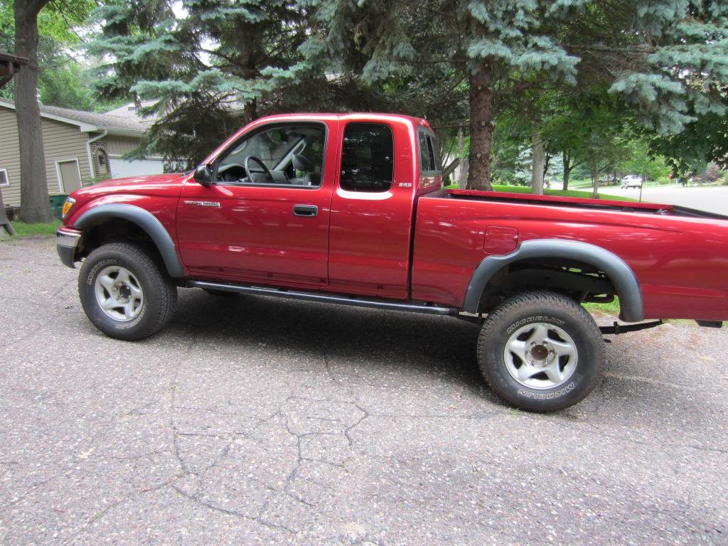

    Before.
    After. The rear axle did move forward slightly but not too bad. There is also a noticeable rake right not but I hope the leafs will settle in and level out.
    Overall, I'm very happy with the install. Final opinions saved for this weekend when I get to drive it 3 hours on the highway followed by 2 days in the rocks.

    Nice setup man. What size tires? 285s?

    I was just about to ask the same thing. Just the little bit of driving today settled in the Dakars and helped even things out.

    Nice. Looks good. Hopefully that rake gets tamed a bit once the leafs settle.
    Gives me an idea of what my truck will eventually look like.
    Check back in and let me/us know of how you like the ride on and off road.

    What I can say for now is that the ride handling is 100% improved over OEM, even with the swaybar removed. The ride is firmer yet not bouncy or jarring...if that makes sense. I have zero driveline vibrations and the Dakars settled in a little. Not sure how much but the shackles have noticeably moved to the rear.

    The axle looks really far forward in that picture

    It does.. I wonder if the springs are installed backwards.
