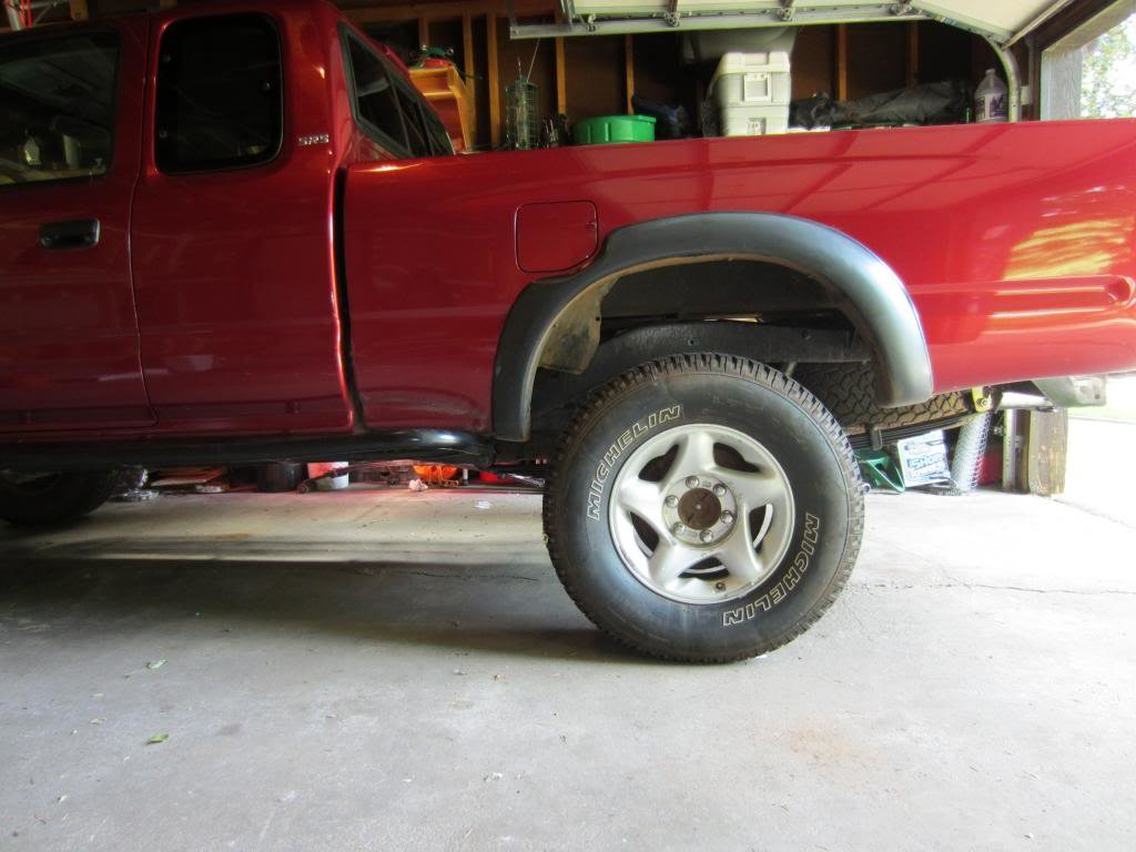

    That would take a special kind of effort to get them in backwards as the shackle bolt is a larger diameter...but it wouldn't surprise me if its been done in the past.
    I did call Wheelers to verify the left and right springs though.
    Edit:
    Here's a pic sitting on level ground. It is still slightly forward but not nearly as bad as it looked in the other pic. Another thing to remember is that with the Dakars, there is still an arch in the spring with plenty of rearward travel in the shackle. As the leaf compresses, the axle will travel up in a rearward arc so there needs to be some additional room for the wheel to fit in the well.

    Just a thought but, I wonder if they are from 95-97. Didn't they extend the spring length for 98 - ? How do your shackles look? Are they pushed forward a bit?

    Nope. Mine were nearly vertical with a slight rearward lean when installed. They've now settled in more after driving it with a more noticeable rearward rake. The driveshaft angles are also good with no binding or vibrations.

    looks good to me.
    The dakars are supposed to push your axle forward a little. You can get an axle relocation plate to move it back or get bigger bump stops if you rub. I never rubbed so i didn't bother with the relocation plate.
