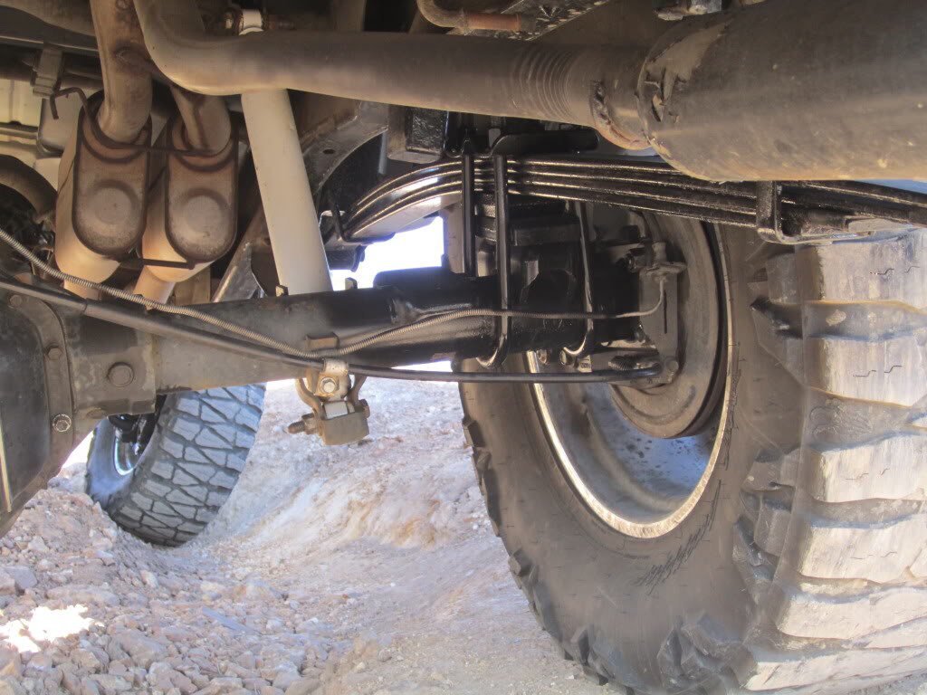

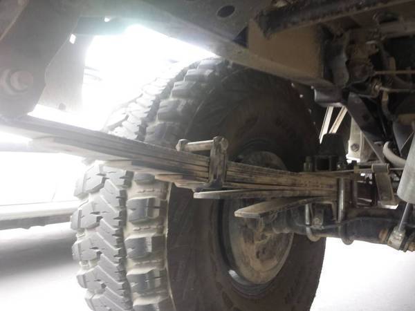

    A flat leaf will provide more flex than an arched leaf. Bigger trucks have arched leafs for load capacity, so I think a lot of people expect arch. An optimum off road leaf pack would be long and flat, but it would wrap easily and be less than impressive on road. Some packs do work very well negatively arched. It's not a bad thing. If the pack isn't designed to go negative, you want to make sure you add bump stops to prevent it, otherwise give your money to charity instead of throwing it away.

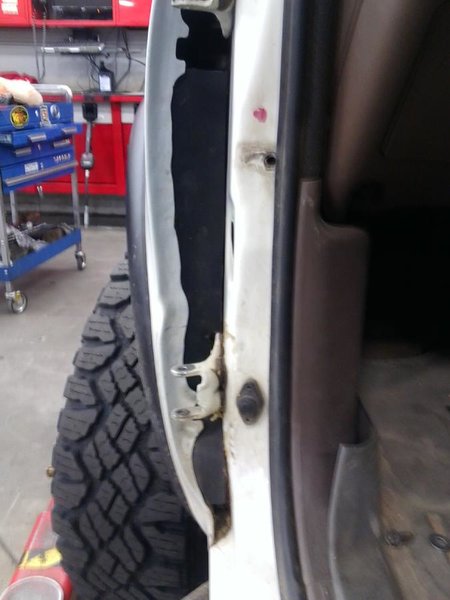

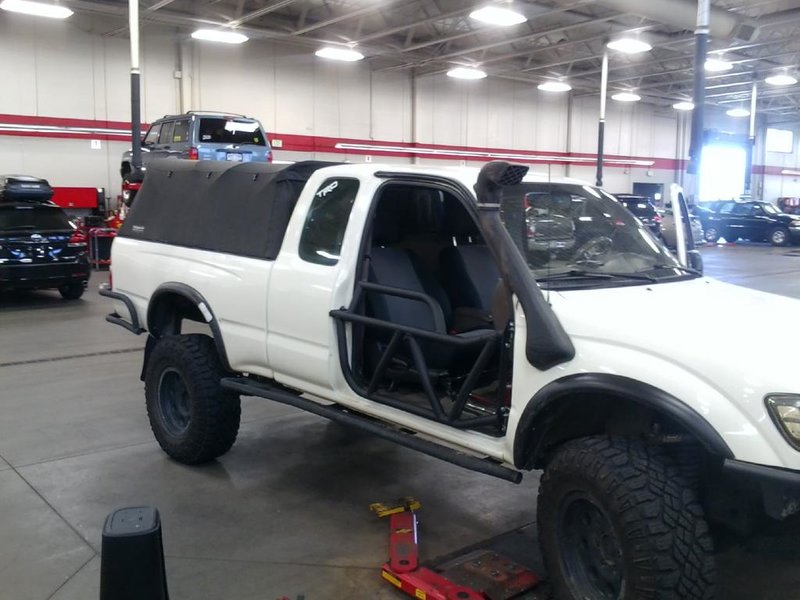

    not finished completely, but got my tube doors mounted up. and sealed off the wheel wek from door area. more info in my build

    Looks great!

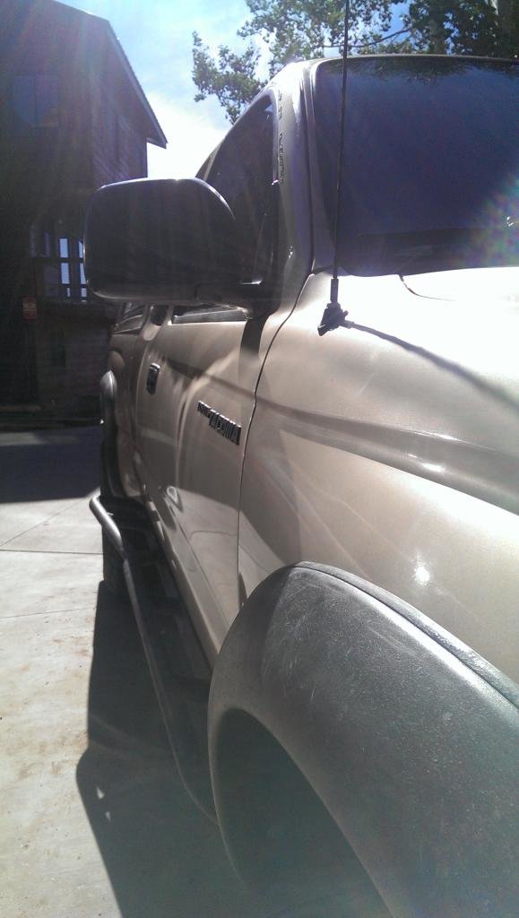

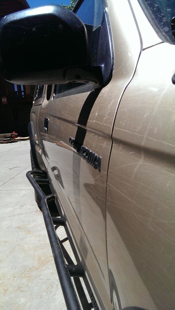

    Gave my truck some much needed love today. Was cleaning it up and tried to remove some of the Colorado Pin Stripes with some rubbing compound, then moved on to a clay bar and wax. Far from perfect but much better:

    first set of tube doors ive seen that i would run on my truck. Did you make them?

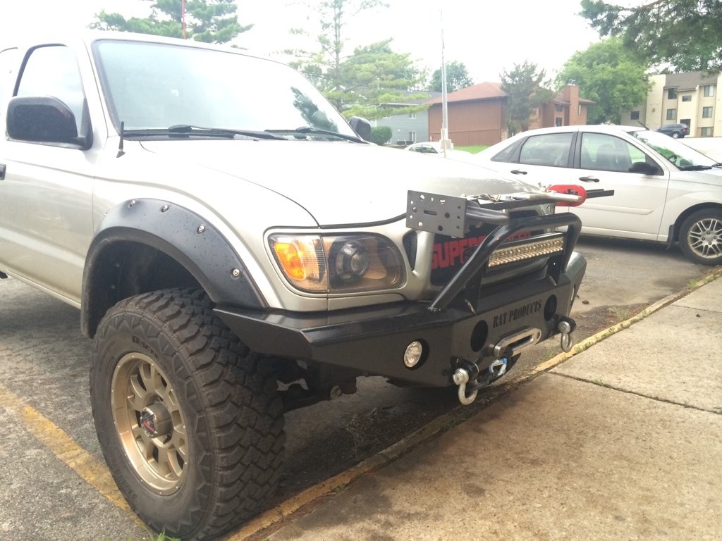

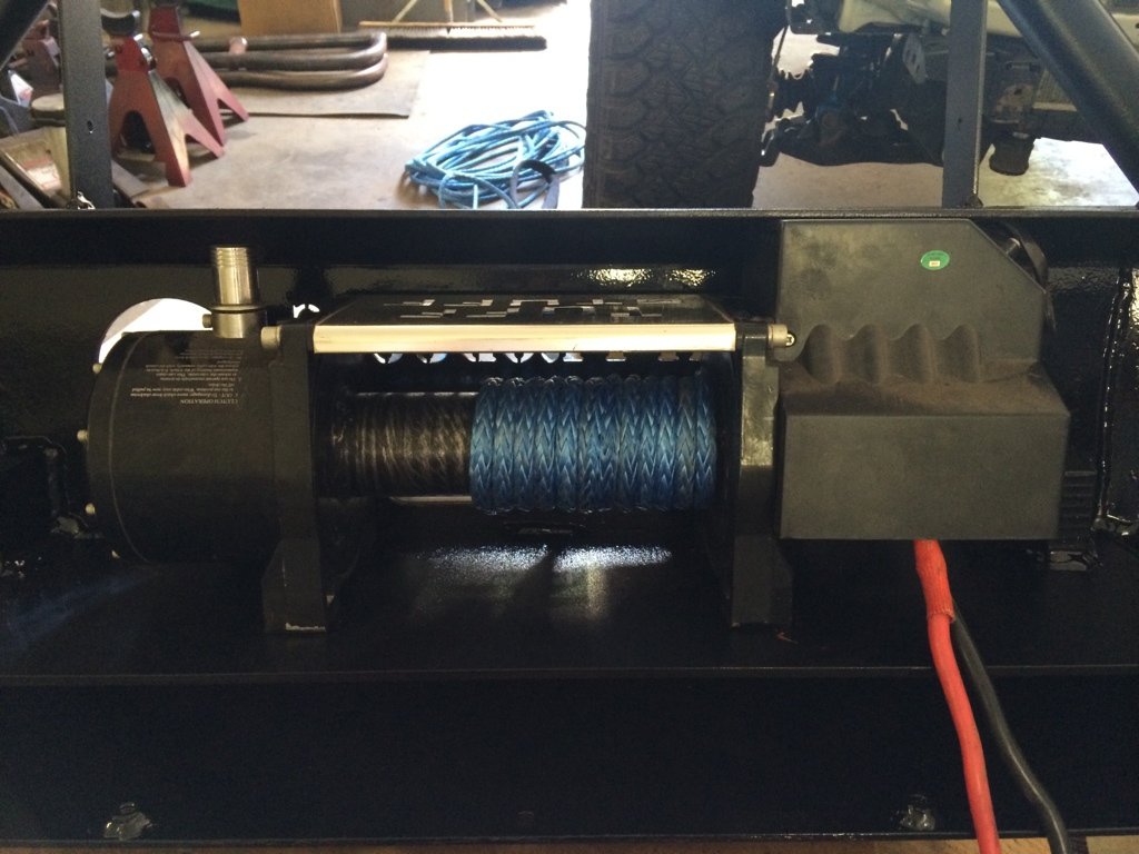

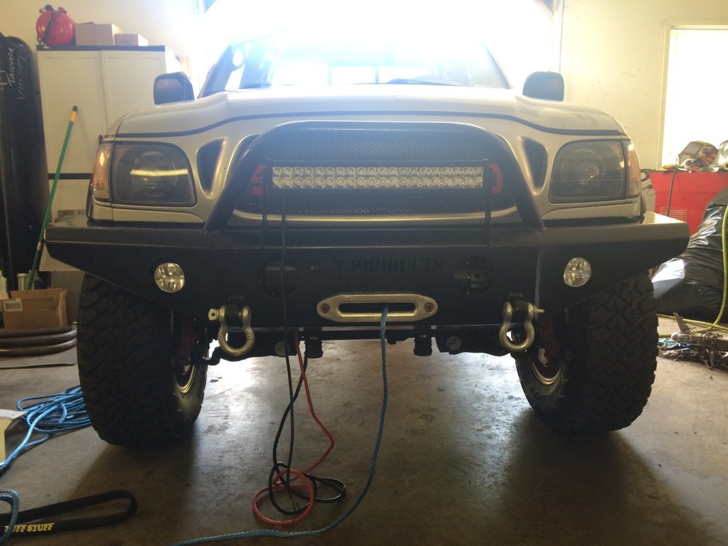

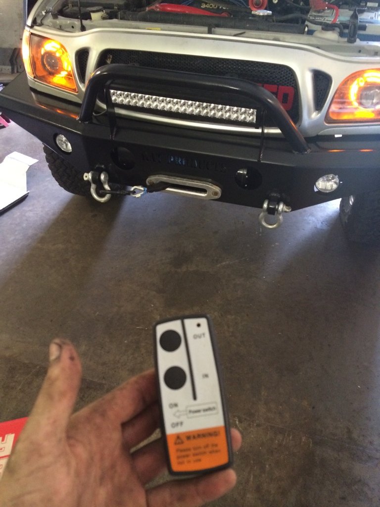

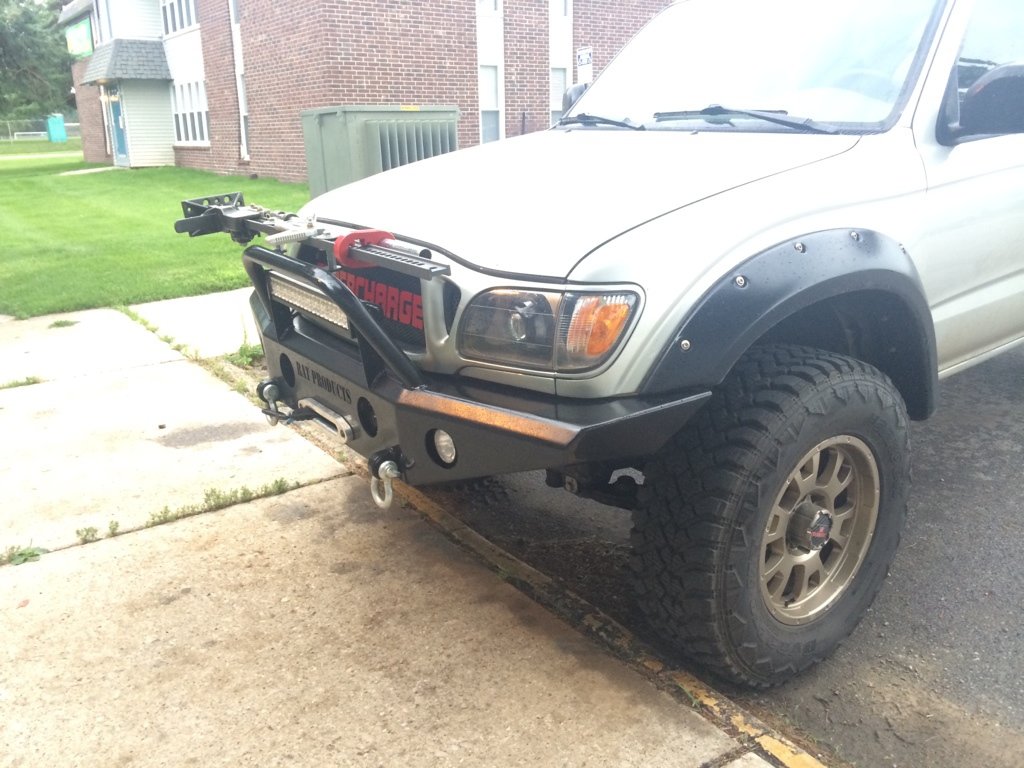

    Over the last few days I got my bumper painted. I sprayed some farm implement paint with hardener added and it came out very nice. I wouldn't hesitate to paint a whole truck in implement paint if I was going cheap. It sprays easily and looks great. I put in the winch too. It fits with literally no clearance. Perfect! It wasn't as bad as I expected to install the bumper by myself with the winch in there. I don't know a total weight but I would guess 140 lbs.
    Wireless FTW!

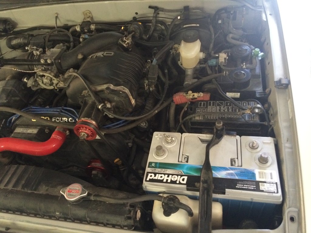

    I also installed my 31M. Man this thing is a beast compared to the stock size. I had to jerry rig the mount, so I will be designing my own when I get back from vacation. It works for now though.

    tube doors look baller jace! youll love em! nice idea filling in that gap in the fender. I love having mud shoot right in the truck, sadly even if I filled in that gap there would be no stopping the mud from the rest of the tire

    One of my dad's coworkers went to school as a suspension specialist in the racing community so I picked his brain about it. He was asking me why I thought my leaf pack was junk because it had no arch, but he said that's good unless you are loading the bed and need the arch as support to prevent you from going negative. There's a good article on fourwheeler.com on leaf springs too.

    Looks good. If you're up here Aug 16, IRO is having their annual trail ride at the Iron Range OHV Park.

    Thanks. I won't make that trip, I'm pretty booked solid after this upcoming 2 week getaway.

    thanks man^ appreciate it! Nah i didnt make them, they are Trail Gear originally, I added the top hoop for an arm rest.
    thanks bud! u were the inspiration for them! you running no doors looked awesome this year in moab. I wanted to do the same thing but a little safer
