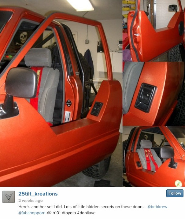

    I've seen one half door setup I like and it's this guys:
    It's beefy, has a cup holder, and can be snapped shut.

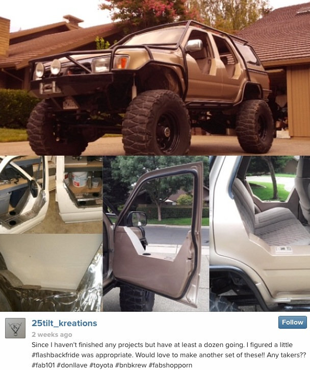

    I like half doors, I think they work on certain rigs. My buddy made both of these sets, follow him on Instagram if you want to see some more fab porn.

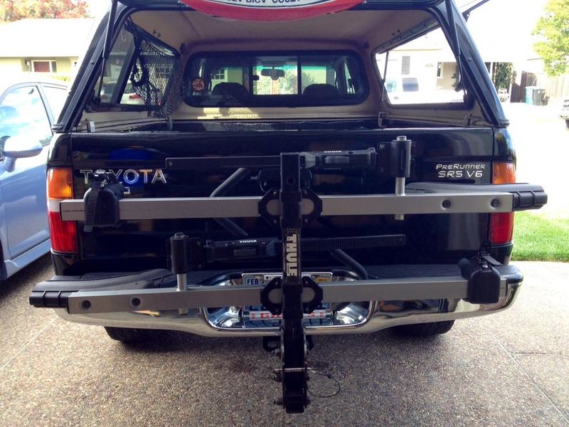

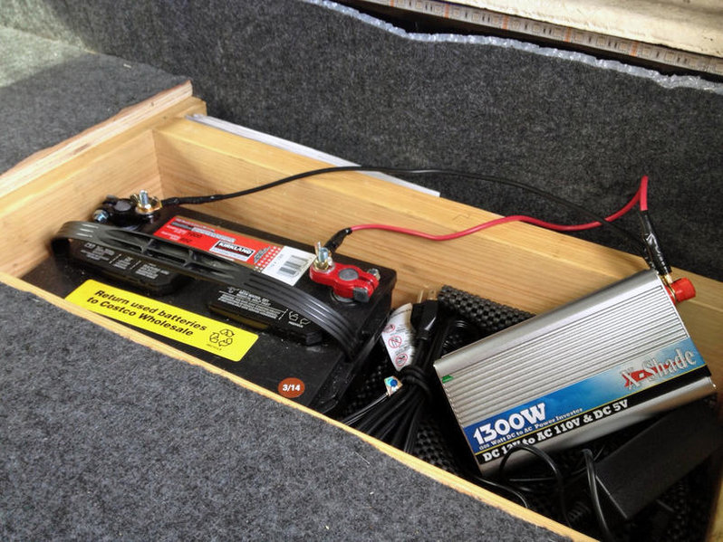

    Hey everyone My name is Dustin and I recently converted my Tacoma into a full custom camper setup. Ill be posting photos to get everyone caught up but until then here is what I did today.
    First photo is nothing special but I finally got the trailer hitch on and am able to use the bike rack.
    The second photo is my battery set up for a second power source. put on marine clamps and trimmed new wires.

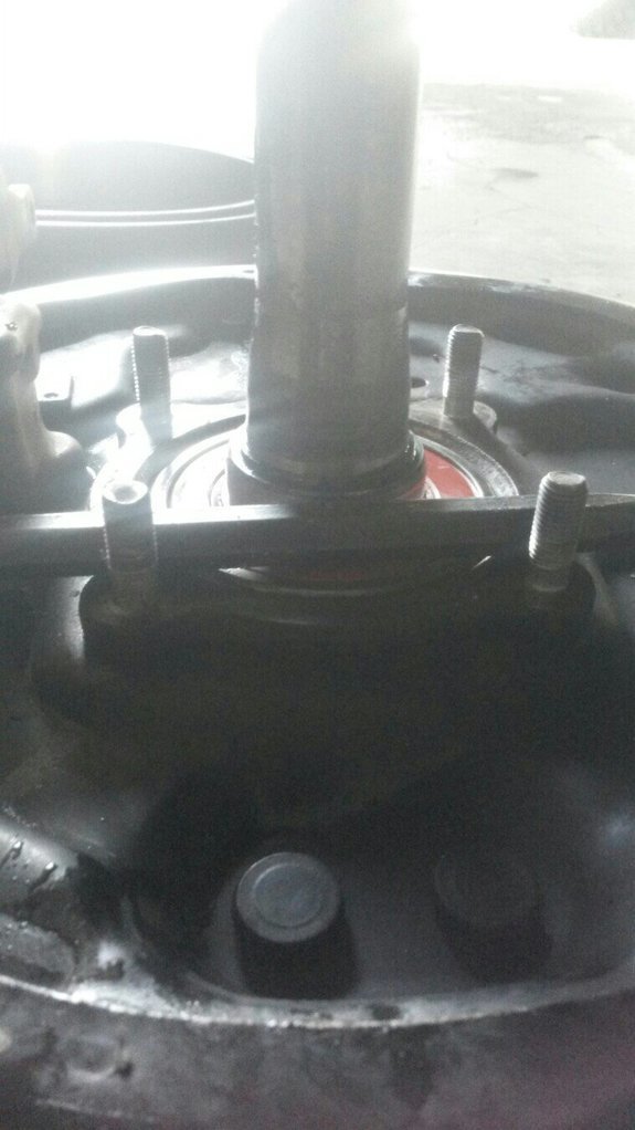

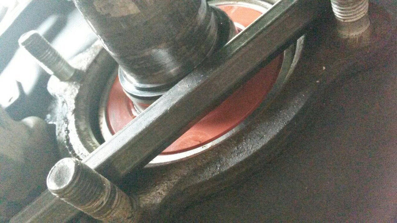

    Discovered the noise in my rear end. This is a pic of my brand new oem wheel bearing installed by toyota. 3/8" of up and down play in the axle.
    First pic shows bearing flush to backing plate, 2nd pic shows 3/8" gap between the top of the backing plate and top of the bearing. Its the same on both axles. qyjybe9e_16af3efff0aa6c464b710f6b8045db2cd1fec990.jpg
