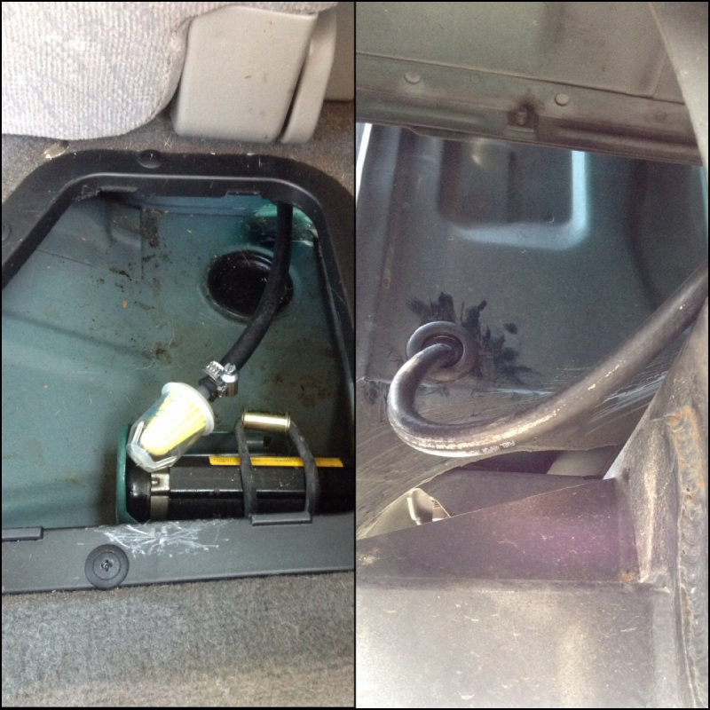

    Replaced my clutch return spring with the stock toyota brake return spring and holy crap what a difference. I thought I needed a new clutch already but found out it was because the stock torsion spring was only sitting in one pocket on the pedal housing. The other side broke off. It actually feels like a clutch now.
    Also I did the rear diff breather, I ran it along the top of the frame into the driver side rear seat compartment. Still need to figure out a simple bracket or something to keep the filter vertical.

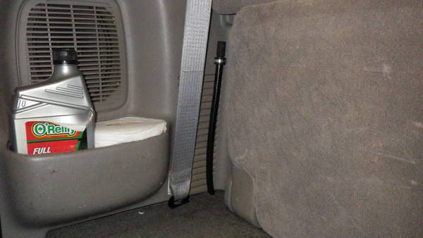

    nice. here's how I mounted mine. just one little screw into the plastic.

    Is it crucial for it to be vertical?

    I don't think so.
    I thought about that when I did it but ive yet to smell anything. and I cant stand the smell of gear oil.... horrible smell

    That's a good point, probably not, if it is than everyone who has them in the gas filler door is screwed.
    Something just tells me It should be, although in reality I'll probably never get to it

    Really doesn't matter with them being relocated where they are. Gravity keeps the breather valve closed until internal axle housing pressure overcomes. Since the breather valve has been moved to a very protective spot, it isn't a necessity to keep it closed all the time (when not venting).

    In the sticky Diff Breather Mod thread there was one guy in there who was adamant that it had to be vertical.
    I never got a straight answer in that thread.

    I've seen breather hoses end in nothing but a hole (on a DiscoII). Not sure why the guy would be so adamant without a reason. The breather valve just uses gravity to keep closed and it keeps closed (unless getting out pressure) in order to keep debris from getting in the axle.
