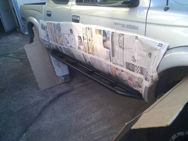

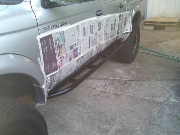

    Trail gear Sliders. finally got them welded and painted them today.
    [​IMG][​IMG]

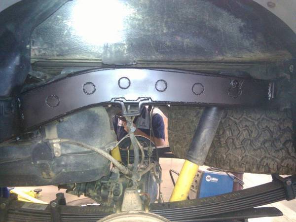

    Trail gear rear frame plates.
    [​IMG][​IMG]

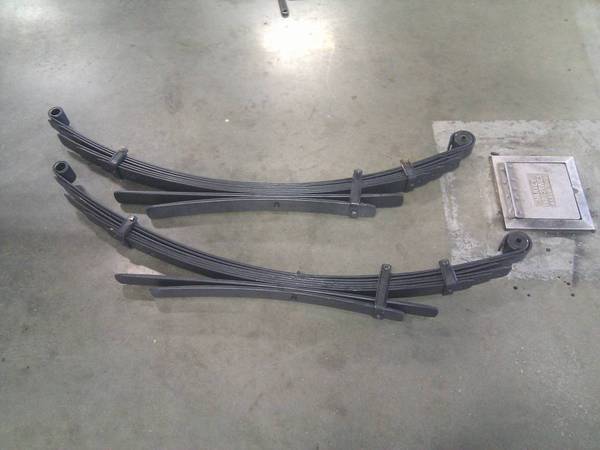

    OME Dakar's with D6XL AAL a few weeks ago, to complete my full OME set. they were on back order when i got the fronts.

    Lookin good! I'm curious, what was your reasoning behind getting the frame plates. The folks I see with them are usually desert runners. Again, just curious.

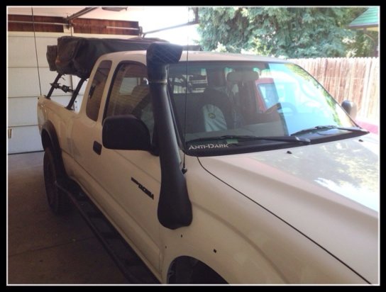

    Mounted the safari snorkel.

    thanks.
    no reason really. just wanted to beef up the frame, one day i might own a RTT or decide to put the topper back on, lol.

    Why put the plate on the outside of the frame? I thought those plates were to box that portion of the frame.

    frame plates are a great idea for our trucks. our frames are really week around that bend under the bed. tugging on straps or being yanked out form the rear, excessive weight payload or pure being mean to the truck.... no its not as good as boxing the frame, but frame plates double the thickness of the frame. great idea, and cheap insurance

    I did notice that the frame isn't boxed from the bed back. But I figured the spare tire mount made it a bit more rigid. I wonder if that plate kit has notches for the shock mounts and spare tire mount...

    they make it for inside and outside. i didn't want to take the spare tire or the bed off to box the inside, the plates will do for now.

    Thats why I haven't done this. However, if you don't box the frame, all you are doing is transferring the stress loads to directly in front of where the plate is welded. If boxed, the load is evenly spread over the entire length.
    Dunno, this may be completely fine but it doesn't make sense to me.
