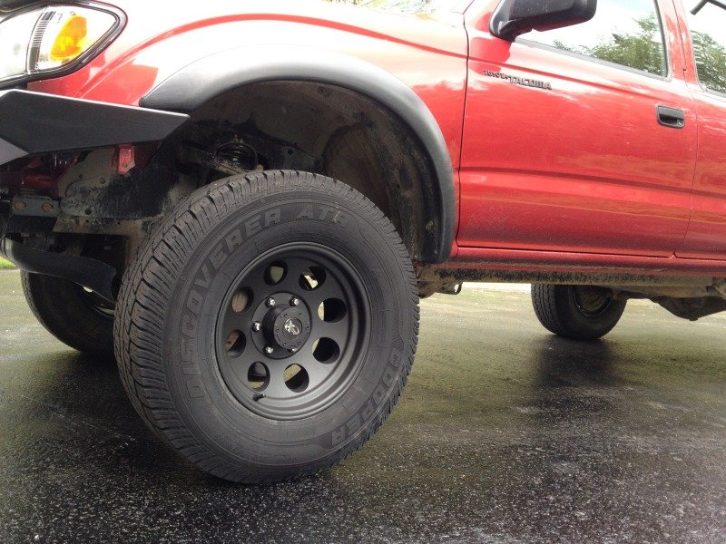

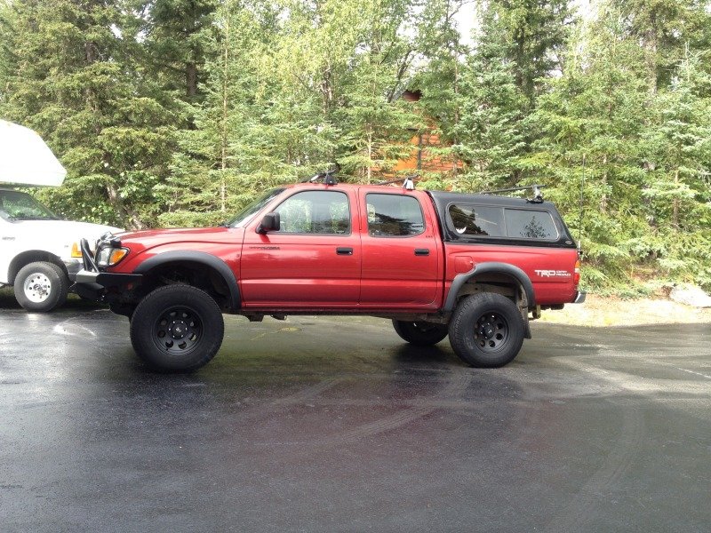

    Got my new wheels installed today. Forgot to order black lug nuts and could only find chrome ones in town. Oh well, the contrast looks kind of OK.
    Next order of business will be tires. Found out today mine are almost 10 years old. Tons of tread left but I'm worried they'll rot out on me before the tread is gone.

    Those pro comp 7069? What size? I got the same thin and can't complain much! Love the simplicity

    Yes sir. I like them a lot.

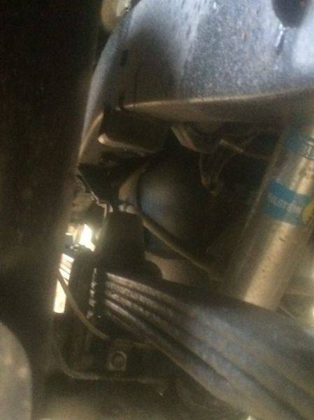

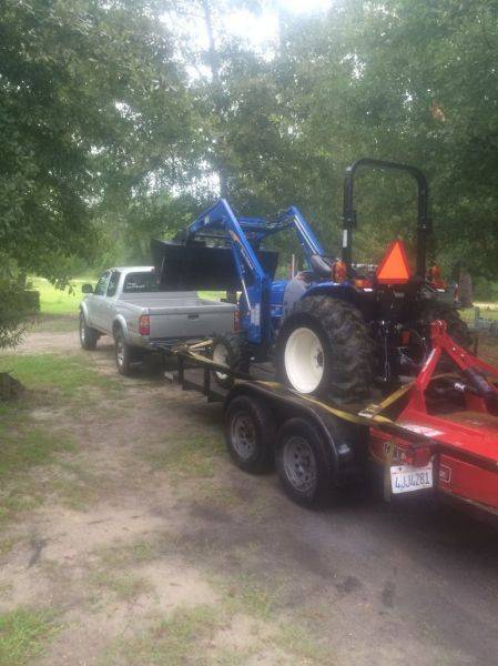

    Has anyone relocated the stock rear bumps after a lift? Towed this today and the shocks looked like they'd run out of travel before the bumps touched.

    Yeah, get some extended bump stops so you don't bottom out the shock. How did your truck handle that tow?

    Such as timbrens?
    It handled it good, it wasn't to bad stopping, but my top speed was 25 MPH, and I only had to tow it a half mile. I stayed in 2WD lo, trans temp never went over 170, and after I was at speed it dropped to 150.

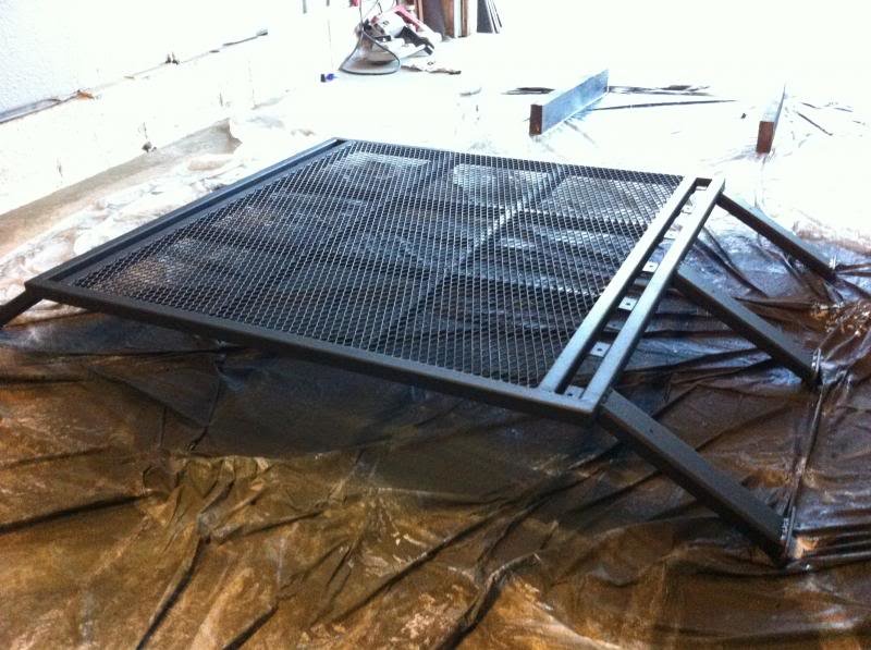

    Throw some mesh on top so that stuff doesn't fall in between the cross bars, etc

    mesh would limit some use though wouldn't it? no rtt first thought.

    I don't have an RTT or Yakima bars (or the likes).
    But if I ever go that route I will just cut out some of the mesh so I can secure mounts to it. Simple enough.

    You could still run a RTT. Just cut holes for the mounting brackets.
