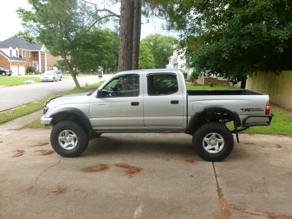

    Intsalled Trail Gear Shackles, OME AAL's for the Dakars, 3* axle shims, and a 1/4" trim spacer. Now someone needs a few more pounds in the bed... :spy:

    Screw weight. Where is the damn turbo mr "it'll only take 2 months" :p haha
    Also I can already tell you'll need axle relocation plates

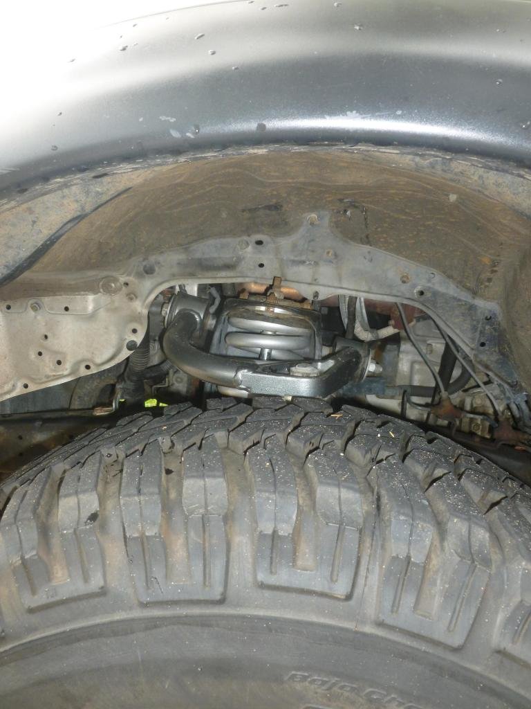

    x2 axle relocation plates for sure

    :confused: Whats that?

    pushes your axle back about 3/4" so that when you flex your tire doesn't hit your flare/inner wheel well.
    Its kind of like an axle shim..

    Gotcha... How thick are they? Im guessing the shim's will go on top of the new plate?

    Ill save these for the ubolt flip/shock relocation mod day.

    Do the axle relocation plates require welding?

    No. just pop them between the axle spring plate and the leaf pack then install u-bolts.

    The D6XL is suitable for CS019R, CS020R and CS021R.
    Edit: You'll need the longer center bolt too. UCB6
