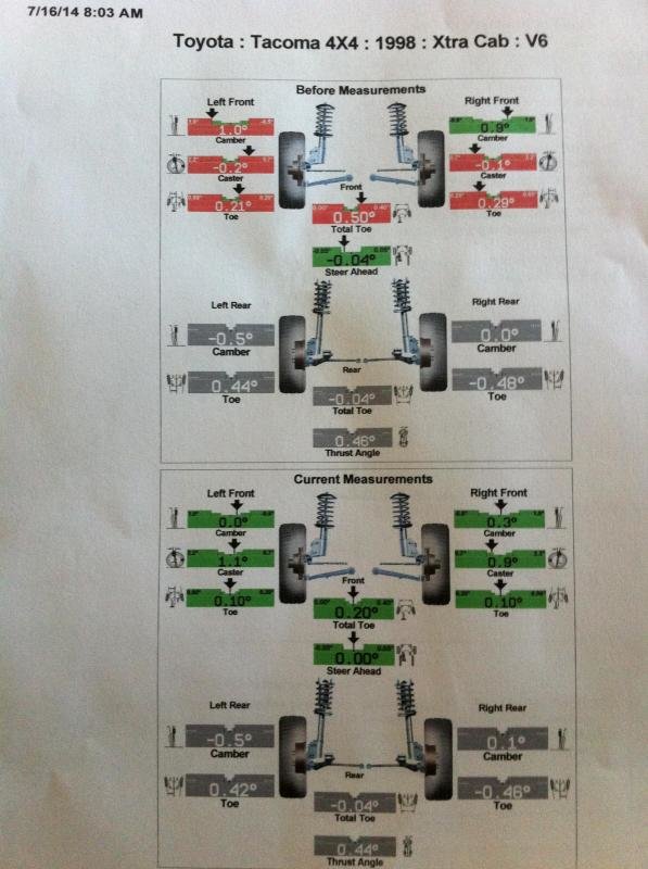

    Go my alignment done.
    Any comments?

    What's a good number to shoot for? But yeah, I am limited due to the stock UCA

    I have no idea. My buddy's shop did the alignment.

    Agreed. It will help the truck track straight on the highway

    ANY lifted 1st gen with stock upper arms can use all the caster it can get. It is safe to tell the alignment shop that's what you want.

    How good a buddy and did he do the work or some flunky?

    Well I'll find out this weekend. 750 miles of highway driving.
    But it'll be hard to tell. Between the steering rack I have, worn out bushings and a non-tack welded steering shaft... keeping my truck straight on the highway has never happened since 1999.

    Best friend of 20 years.
    All their techs are top notch. They are constantly rated amongst the highest shops in the area.

    Fine, I was sorta half kidding.
    With, as you inferred, a rack problem and loose steering column, there should have been some kind of feedback. Maybe there was, I wasn't there.
