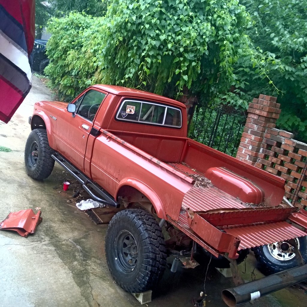

    Technically its a 1st gen...

    TacoREX
    TacoREX -TacoREX
    May 17, 2014
    #130048
    219
    Evan
    NORCAL
    01 Taco 2.7 5spd
    2.5" lift, 285's, CB, DIY HiLift Bed Mount, AllPro Sliders,Warn
    Wish my first gen had that bed! love the outside roll on those older trucks!

  20. Jul 21, 2014 at 3:00 PM
    01Tac0ma
    01Tac0ma Bash Fabriction & Off-Road
    Jun 11, 2010
    #38782
    6,304
    Chad
    West Columbia, SC
    SAS 01 TRD 4x4
    Look at build!
    You and I both! If I could make one fit my truck it would already be done!
