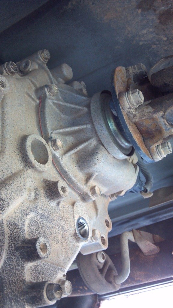

    I've done it twice. It's not difficult, the only PITA is that the nut on the flange is staked. Do it on a hill and I don't think you'll lose any oil haha
    Pull off the flange, pry out the old one with a screwdriver and tap the new one in. Done.

    Thank you Sir! Pics are very much appreciated.
    Just picked up the seal, crawling under truck now.

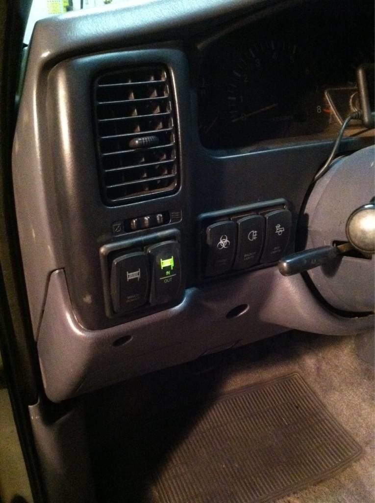

    FINALLY wired up my e locker. Nevermind the fact that it says winch controls. Still need to get the right cover plate. So stoked to try it out this weekend.

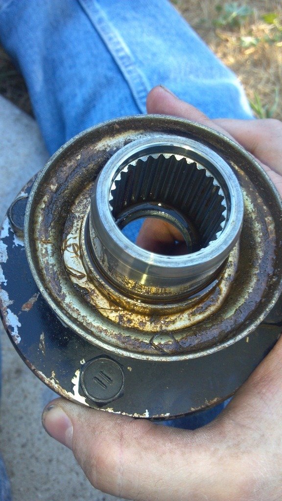

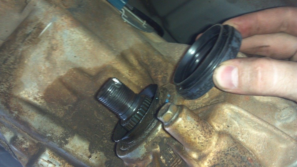

    Replaced the front output seal, started at 1:30, finished at 3:05. Thank you 45ACP for the pics, you're right the nut was the hardest part. :thumbsup:
    Honestly, I think the dust shield may have been why it failed, there was a lot of crap inside the shield, most likely churned up from the latest deep water crossing. Either way, it's ready for more.
