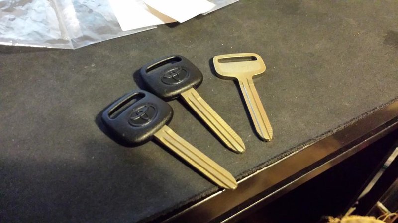

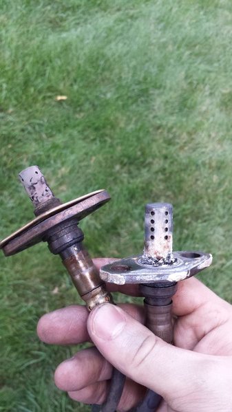

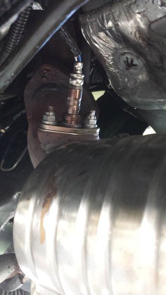

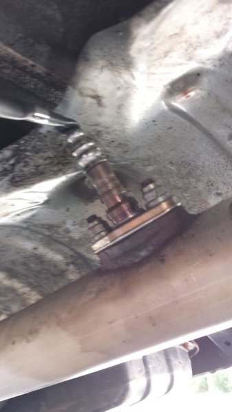

    I finally stopped complaining and got around to doing the o2 sensors. New nuts, gaskets, and sensors all from the dealer. Got new dealership keys for my birthday too :) They replace my old cheap copies. 50/50 acetone and ATF mix made those bolts SOOOO easy to come off. I didn't even have to strain. Just had to soak for at least a whole day.

    Rockauto has the Desnso O2 sensors cheaper than anywhere

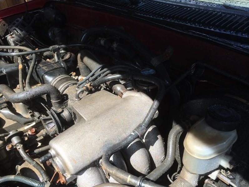

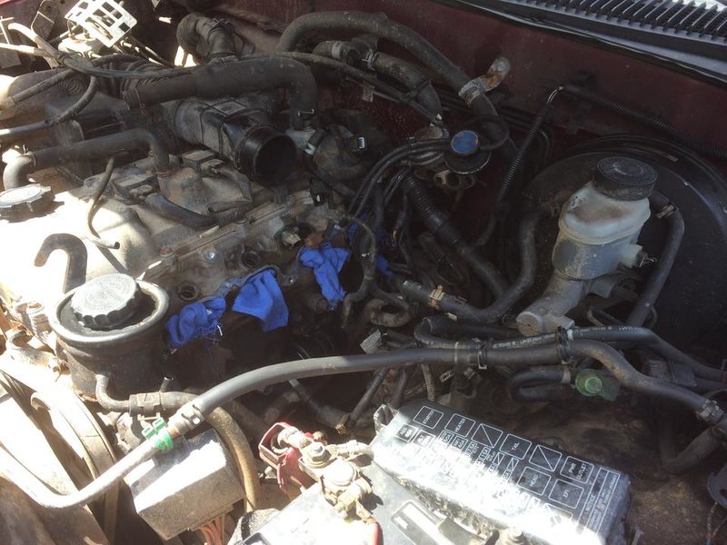

    Took off the intake manifold to clean it all out along with the TB. Cleaned the injectors and changed the fuel filter while I had it all apart.
    Together:
    Apart:
    Super easy to change that damn fuel filter when you can easily reach and see everything.
