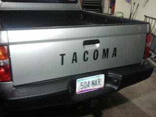

    I debadged my tailgate and this is how I did it . Get a plastic narrow putty knife that is flat ( not metal ) Use a spray bottle with water and a few drops of soap in it and spray the top and and bottom and sides of the letters , then put your plastic putty knife and under one corner of the letter and wiggle it off with the knife . the key is keep the letters wet so you dont scratch the paint , it comes off so easy that way, took me 20 min to do all the letters . Then with a cleaner wax , clean the glue and goasting off . I tryed the fishing line method and it sucked , just cut through the letters and my skin , my way went four times faster . Let me know if you use this method and how it worked for ya .
  3. Aug 13, 2014 at 11:38 PM
    muddog67
    muddog67 Well-Known Member
    May 10, 2014
    #129529
    2,255
    just took this pic for you to see

    A super easy way to de-badge is to take some fishing line, cut a few feet of it, hook it under the emblem and pull up and down like you are sawing the glue behind the emblem. Wont damage the paint and comes off pretty easy.
    Found a video, too easy. Hope that helps

    I did this method but Heat gun + putty knife.

    I thought about the heat treatment but i was afraid of hurting the paint .

    Well I do understand your concern but if you use a good cleaner wax ( Im a huge fan of meguiars cleaner wax in one bottle ) you should be ok . I still see a little goasting of the SR5 when I removed them from the side next to the side window but thats no big deal to me . I live in phoenix and the sun is really hard on our paint here and my truck is ten years old so it wasnt to bad

    I was actually able to rip mine off with my fingers. then just rubbed off the let over glue with my finger.....had some nasty blisters but owell...lol.....then I waxed the truck. no sun fade here

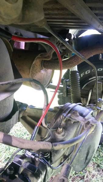

    Put my new brake line on today:cool:

    If you're in Phoenix I'm pretty sure there's plenty of ambient heat in the heat of day.
    I live in Colorado and I debadged mine in August when it was 100 degrees out. Didn't need fishing line or anything. Just peeled them off with my fingers.
    Afterwards you'll need to put some elbow grease into it. I removed the remaining adhesive with Goo Gone. Then washed, clay barred, polished, and waxed the truck.
    After removing the badges 11 or 12 years later on a dark truck you couldn't even tell the difference in paint.
