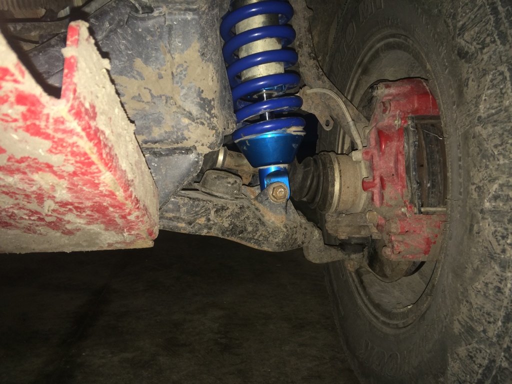

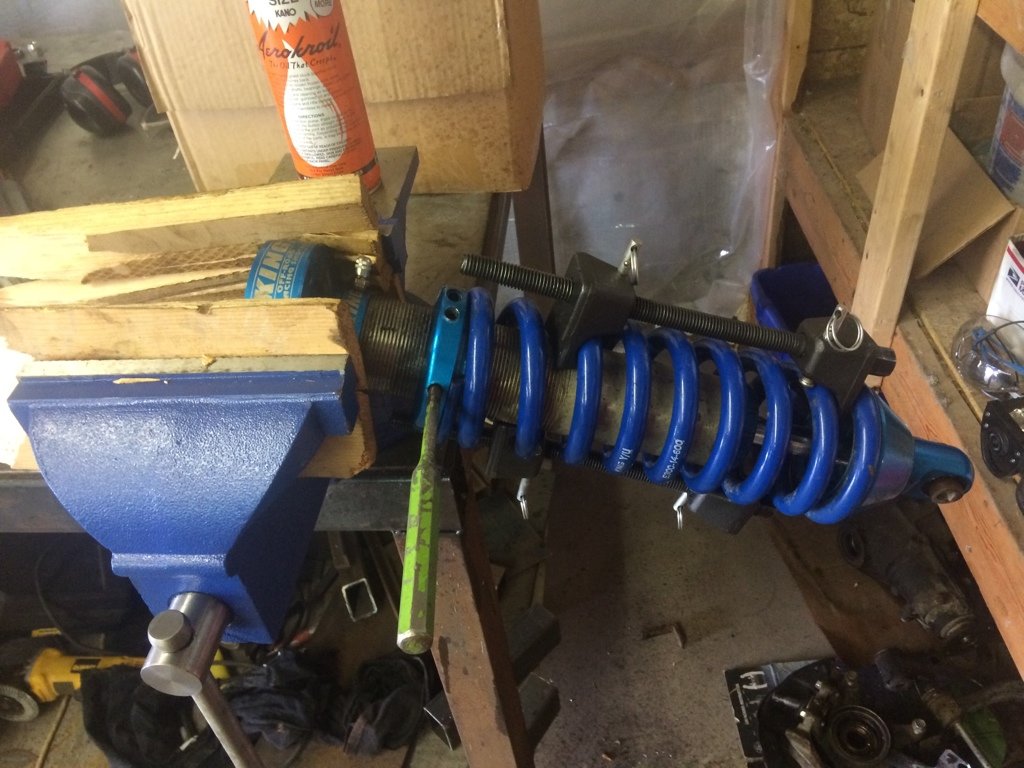

    Raised my kings a couple more inches. What a bitch and a half. I had to use a spring compressor and pound the piss out of a harbor freight punch to get any movement out of the collar. No way could you do it easily on the truck.

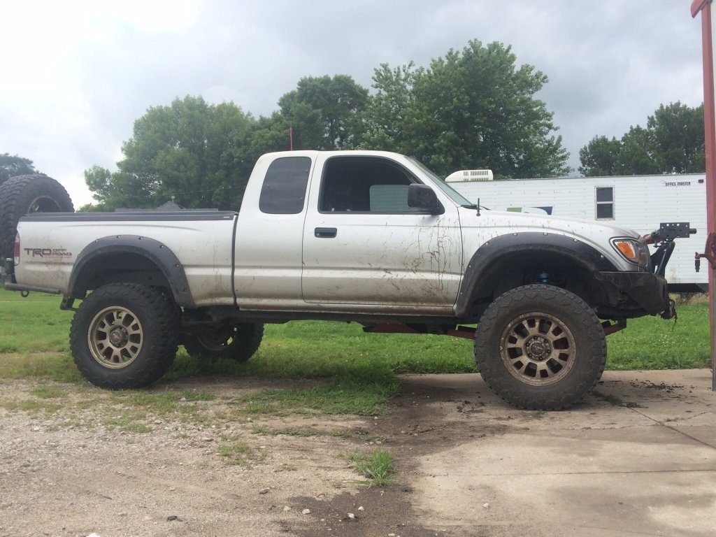

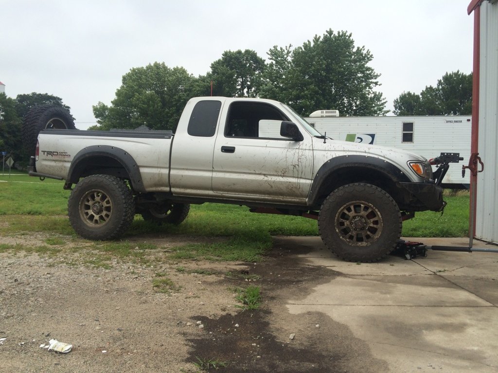

    Before:
    After:
    CV angle is still okay:

    I am sure you know it is a 2 piece collar. I was looking at adding a few to my Kings but have not done 8th yet. King is only 3 to 4 miles away from me so I may just have them do it.

    It's definitely 1 piece...

    Sounds like the collar is crossthreaded. It happens with Kings if you loosen the allen lock key too much. My 10 year old son can adjust mine as long as the collar is on the threads correctly.

    They have been like this since the day I bought them brand new. I tried to crank them up while on the truck back then and broke 2 punches that king provided before I got half a turn. I finally decided to pull them off and do it this way. Maybe they came cross threaded but I checked and they look pretty normal.

    Yeah that's not normal.

    Probably worthless to contact king at this point. I didn't think it should have been that tough, but I had no clue.

    I would contact them... Sounds messed up to me.

    I might contact downsouth motorsports first. I think I've heard that sometimes the build the kings themselves or something.

    Oops never mind I mentioned split collar
    Not 2 piece....
