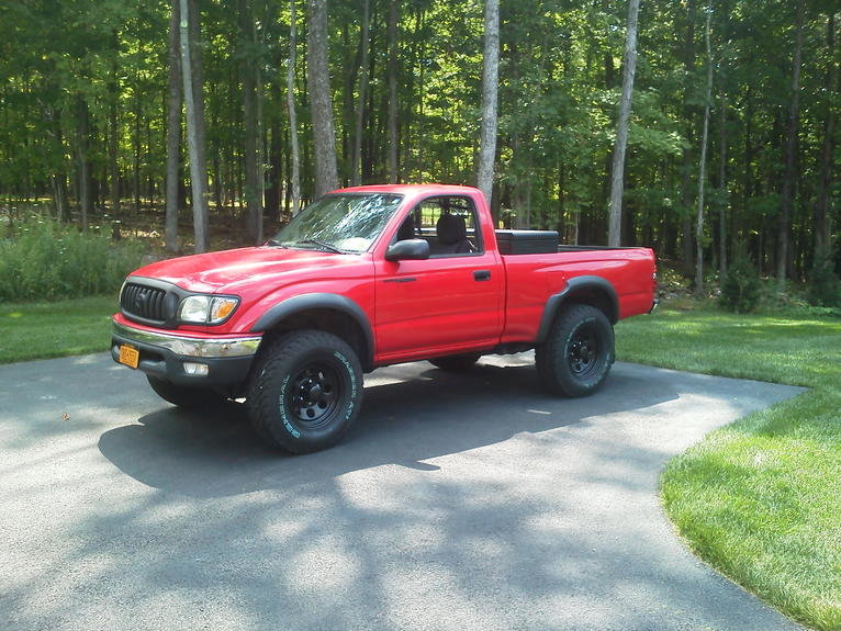

    Black rock steel rims and general grabber at tires from tire rack
