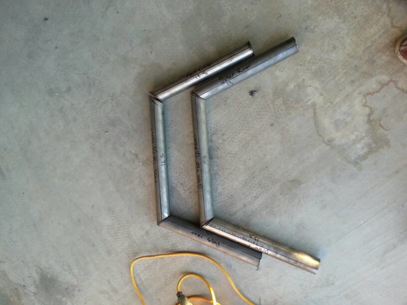

    Got my shock hoops cut out. Going to bevel the edges and then weld em up. 0eb5068c635ec03c4e6cc85c77a841ab_da71b2a0c7679ef18c78e1fc3d9c57fc7bb4683f.jpg

    That would be the easiest way so you can get all the misc parts that go along with it. Little things like radiator hoses, alternator, etc etc.
    Ok.....
    But why not get tubes bent? A miter cut/weld on corners is just going to be a weak point. Really not a good idea considering what you have planned.
  17. Aug 27, 2014 at 7:50 PM
    jberry813
    Jan 21, 2011
    #49636
    28,478
    Jason
    Lake Tahoe
    2012 DCSB Sport
    ...too much shit to list.
    Not at all.
    Hard hit and that will fold like a twig. Without a consistent bend, you literally are telling the tube where to bend and/or break. Especially considering it's going to be the upper mount for the coilover where the entire weight of the truck will be supported.
    In the end fabrication is just a hobby for me, but I know what's worked (and not worked) for me in the past. I would STRONGLY urge Juan to get some tubes bent instead of that.

    Maybe he has gussets and shit planned too?
    Maybe...but would you use anything other than a bent tube for a shock hoop?

    No. If I don't have to weld multiple parts together, I don't. One continuos piece is the way to go. A bent tube would take up much less space compared to that too... Unless it needs to look like that, which can still be bent.
