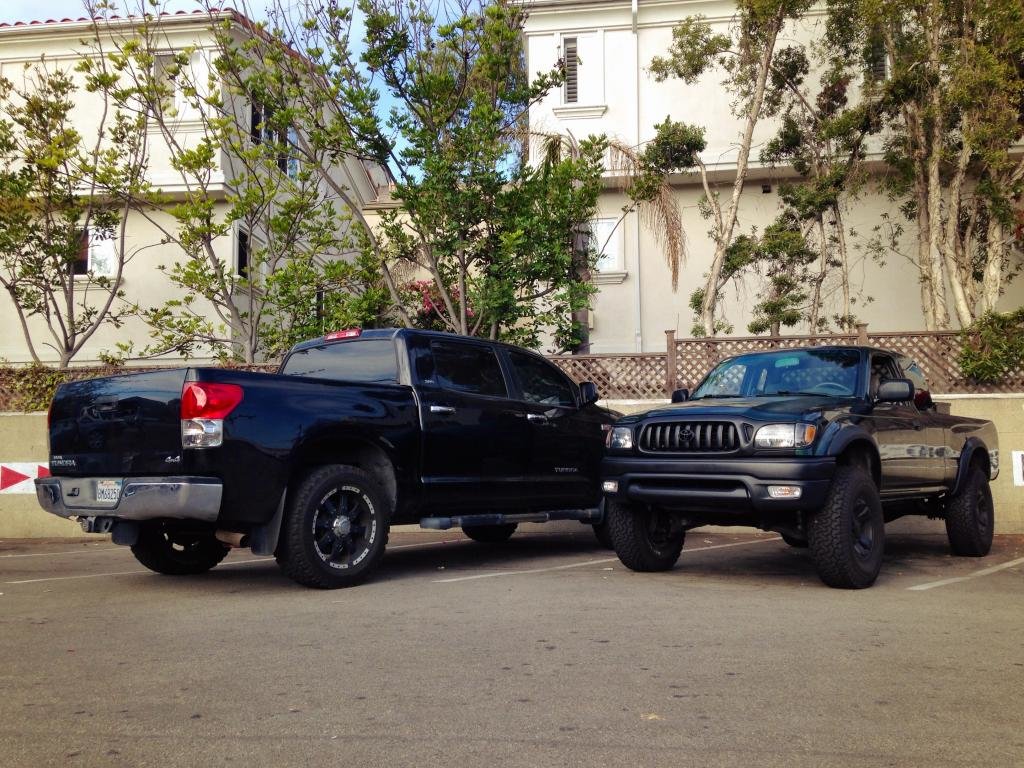

    Makes my truck look tiny lol :anonymous:

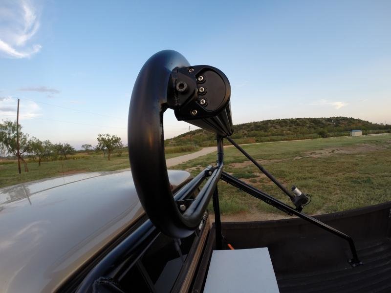

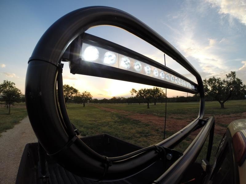

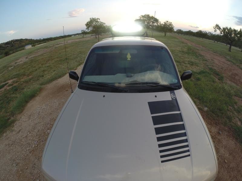

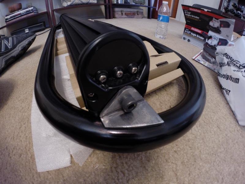

    Finally got my first LED bar mounted and wired up on the new light bar set up.

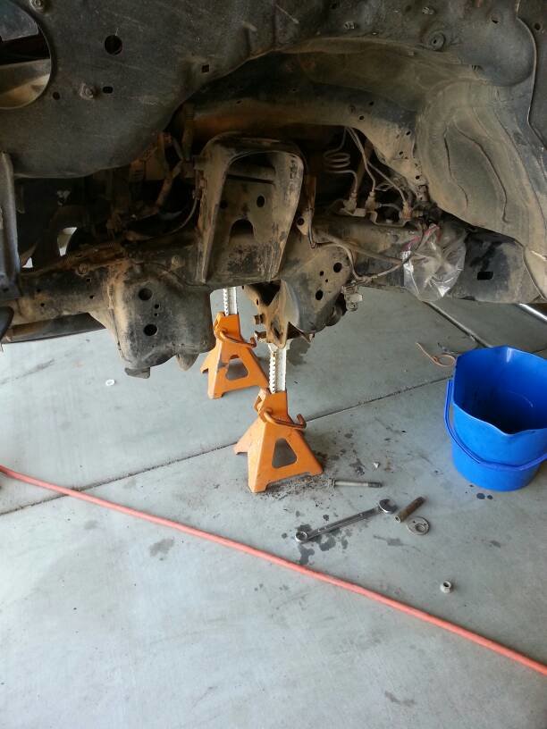

    I had to do this to mine
    Front diff assembly-2.jpg by Monte Nickles Photos, on Flickr

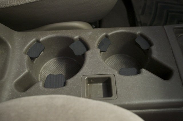

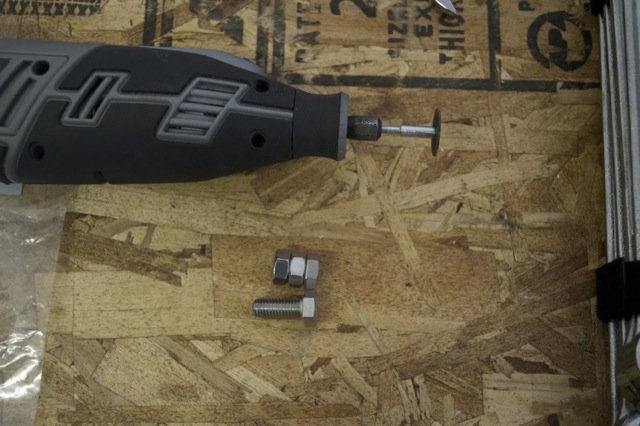

    Replaced the cup holder tabby things:

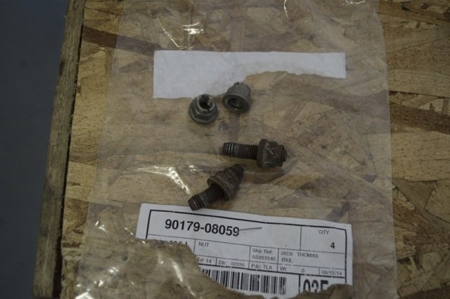

    And had to make up some O2 sensor bolts when I tried to replace the O2 nuts and the studs threaded out and bent all up.

    How did you make the O2 bolts? I broke one and made a stud out of a bolt and took it to a muffler shop but they told me they couldn't weld it on.

    Picked up some stainless steel M8-1.25 bolts from Lowe's and cut them to size using a Dremel.
    The 3 nuts you see are actually a bolt with two nuts threaded on so I knew where to cut and then used them to chase the threads clean.
    I'm going to look around for some new studs but works for now.

    I got that far but how did you weld them in?

    I didn't. The old studs were threaded. Just screwed them in. This might be a little different than stock since I have a Magnaflow cat-back kit installed.
