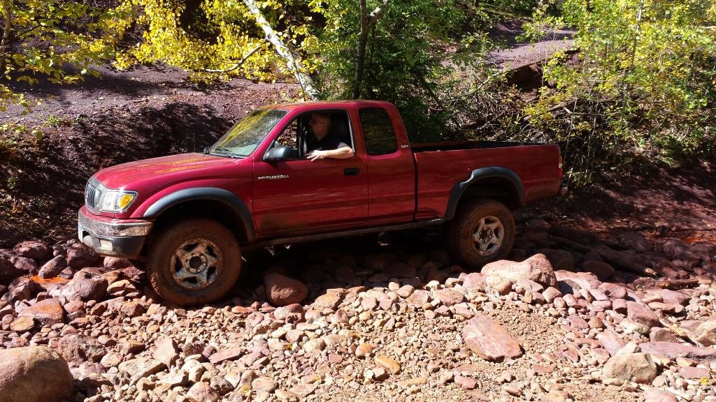

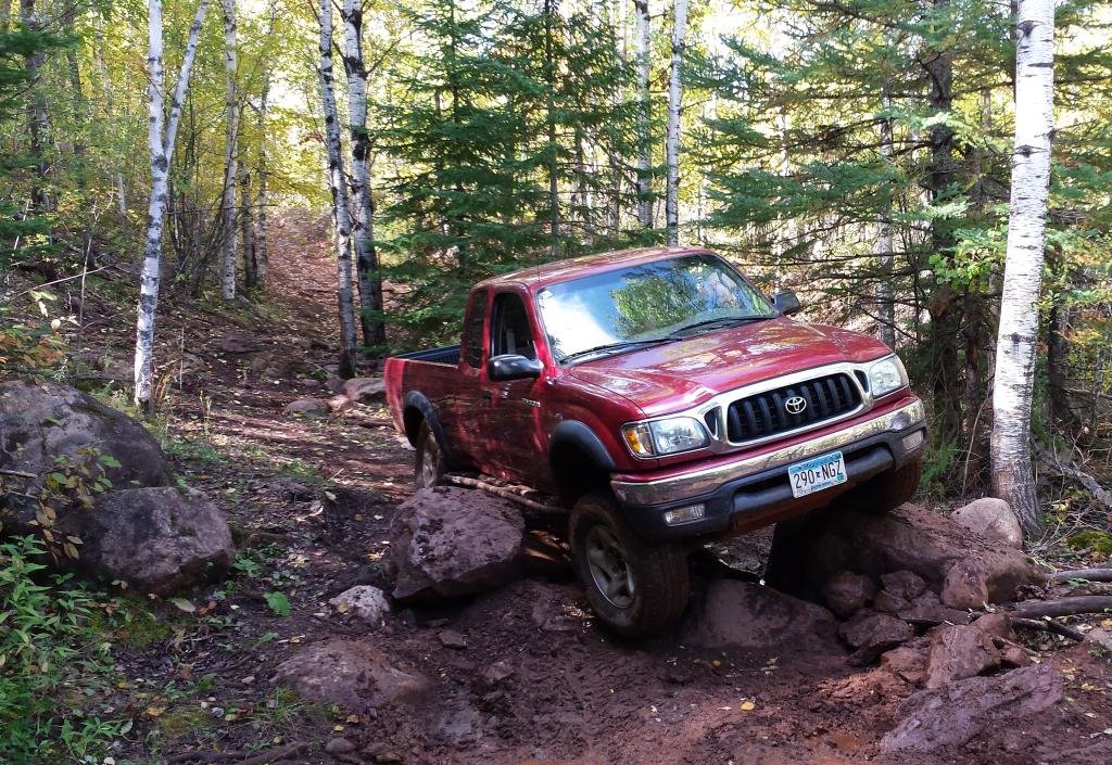

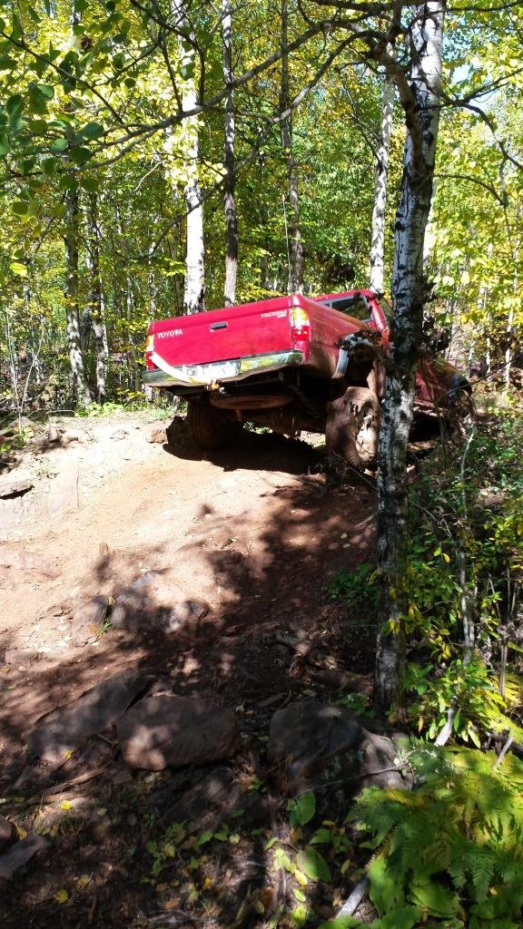

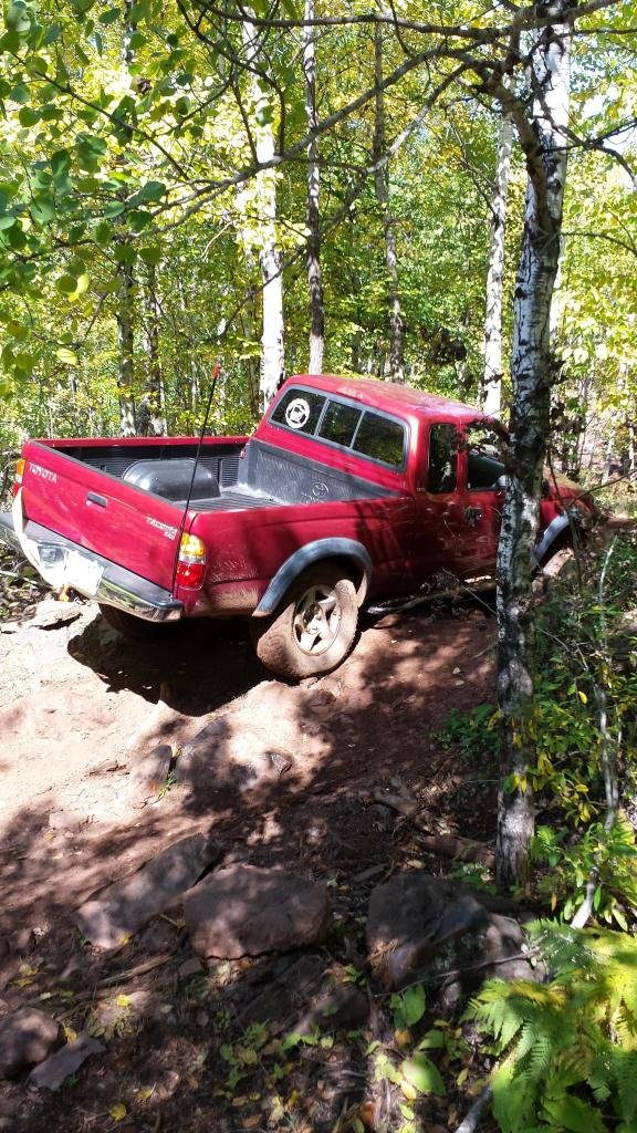

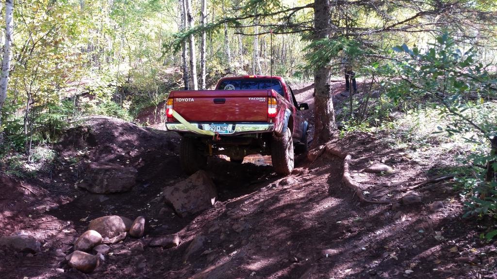

    Here's a few wheeling pics from this weekend and a few things I learned:
    1. Need LCA skids. On several occasions, I hit and nicked my LCA's. Thankfully, there was no real damage but that's something waiting to happen.
    2. When I regear, need to look at an ARB for the rear. Having a non-TRD hasn't limited me yet but there are a few pics and videos where I have a front tire off the ground spinning. I also got stuck in one area when my open diffs left me spinning my tires.
    3. High clearance bumpers and a winch. I rubbed my front bumper in a few areas and the rear hitch slammed down on a few rocks. Adding approach and departure clearances will help alot with that.
    4. The OME lift flexes very nice. The rear has a very nice amount of flex and the IFS isn't too bad but there were occasions where I left a tire in the air.

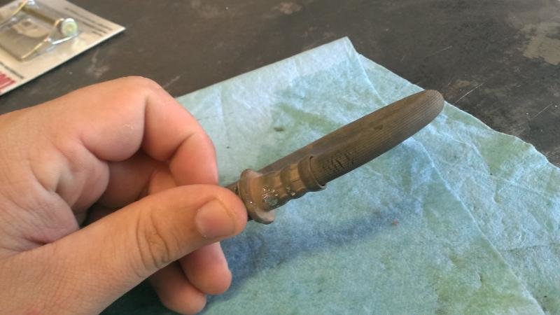

    I installed a Dakota Digital SGI-5c to correct my speedometer. It read 60mph, GPS said 69. Install was daunting at first but it was easier than expected. It is dead on now, great product but the instructions aren't taComa specific. I used the following write up, took about 2 hours due to reading, wrenching and programming. I also fixed my steering play and rattle. It was very annoying to feel that bump and shake of the steering wheel every time I backed out of the drive way or hit a pothole or something. I used this write up (post #43 shorcut). Total time 45 min. My truck's steering feels brand new! Highly recommend this one for every taComa.

    Why not just change out the gear in the transfer case? $20 part from Toyota and takes 5 minutes to change.

    This is what I've always wondered but haven't had a need to research it yet. On my TJ, all I needed to do to recalibrate my speedometer was to swap a plastic gear in the t-case which read the rear output shaft for speed.

    I attempted to fit a 33 tooth gear in the transfer case. It was a no-go. Haven't tried a 32 tooth yet but I'd still be sitting high on the speedo with my 285/75r16s and 4.56 gears, by about 1.5%.

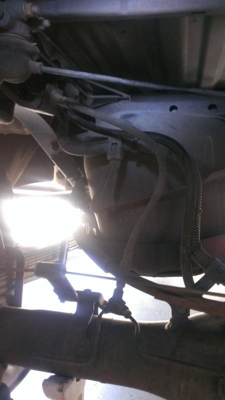

    Went from this:
    To this:
    Because of this:
    I've read all over this forum and others that you don't need to replace the rear brake line if you do a lift in the back (bull crap). The deavers in the rear (with one leaf removed) articulate enough that the axle was pulling the stock brake line tight.
    So for all those out there that don't think you need to replace the rear brake line after lifting it...double check it and make sure you are right. Maybe mine was special, but this is a pretty common lift (deavers and OME shocks in the rear).

    I swapped gears in my 97. I had to "tap" the gear into the transfer case, but it worked great. I have 4.56 gears and 33s as well. Look at my build for # of teeth.

    I may just tack on a 32 tooth to my next Camelback order and try again. I know for sure, the 33 tooth was not going in. Anything is better than sitting 7.5% high like I am right now.

    Running stock 4.10s, 255/85/16s, and a 28 tooth speedo gear. Speedometer is almost dead on according to GPS.
