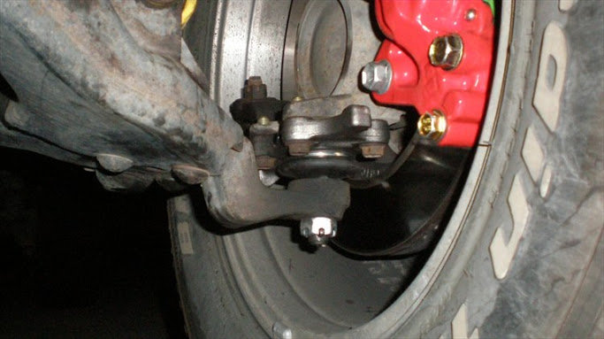

    Has anybody done their lower ball joints and had to cut off the rivets to replace the entire assembly with a new lower ball joint that bolts into the lower control arm??

    The LBJ has 4 bolts that go into the spindle. Remove those. And then there's a castle nut that holds the LBJ into the LCA. Remove that and pop the ball joint with your favorite ball joint tool (I use a pitman arm puller).

    Takes like 10 mins to do. Maybe. Should be able to do both sides in an hour.

    Hell i didn't even use a puller, just gave it a few good hits with a bfh and they popped out.

    Same here.....just a few taps and mine came out with no problems. Pretty easy job IMO.:)

    First time doing it and listened to the first person who explained it to me. Dumb me. So I literally just have to replace the ball joint? AWESOME. Not as much work as I thought ;)

    Ya you just have to replace the whole thing...

    wait yeah thats what the guy was trying to sell me....

    That's it. 4 bolts to the spindle, and you put the otre into that piece that sticks out to the left in the picture.

    Yea..there are 4 bolts on the bottom of the spindle. That holds it to the spindle. Then the main nut on the bottom of the LCA is the ball joint stud. The arm looking part is for the outer tie rid

    Here's a picture of one installed. You can see the bolts on the bottom that attach to the spindle

    Wow okay I was really confusing myself. You are guys are awesome!!! Thank you so much!
    Im adding coilovers and redoing the ball joints and tie rods.
