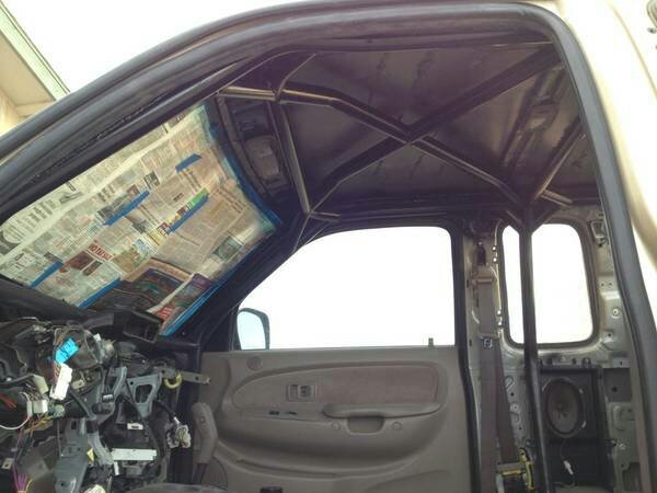

    Trail gear 3 Link Solid Axle Swap kit, 14 " Fox coil overs with reservoirs up front, Chevy 63 leaf spring swap with ruff stuffs Chevy 63 swap kit, 14 "Fox shocks on the rear, 37" tires, Custom front bumper by Next Venture Motor Sports with a warn winch, glassworks unlimited fender flares, custom rock rails with kickups (modeled after Relentless Fab Rock sliders), rear bumper from streetacos.com (with custom rap around protection for fiberglass fenders and the hitch receiver hidden behind the license plate that is on hinges), HID off road lights on front bumper, rigid pods on rear bumper with red back lighting, high lift mounted in the bed, onboard air, Flowmaster muffler, aftermarket air intake, alarm system, Alpine Deck, Alpine amp, Alpine speakers, JL W6 12" subwoofer, JL amp.
    He has. Not sure if the other tacoma is on here. and and I rolled my last truck. Not trying to roll this one. but it is for looks and function. I had it go straight down the cab instead of across to make a triangle so it wouldn't be over my head. Hopefully I never have to use it.

    Thanks. and no. First cage I have ever got. I will definitely change stuff up next time. Thinking about going to the frame. but ive heard it will make the ride alot noisier. and my friend said this is how alot of people are doing it now. Just down to the floor with the bar running along the floor connecting the base. and he used 4130 DOM

    It's not tied to the frame???
    What's the point then????

    wait it doent go to the frame? does it bolt to the sheet metal cab?

    It is welded to a metal sheet then thats welded to the floor of the cab... Should I go threw to the frame? We talked about welding to a metal sheet on the floor of the cab and then another sheet on the bottom then welded to the frame. But he assured me that with the bar connecting them at the bottom it would be fine. If he is wrong please tell me. I don't want it punching threw if anything does happen. and i am going to get pads for the bars by my head. just haven't got them yet.

    you should scrap it. Make it triangles. And go straight to the frame. Cut holes and run the tubing to the frame.
    Otherwise, just a death trap.

    really? :bananadead:
    even if i weld it to the frame it will still be crap?
    And can it really make it worse and more dangerous if I flip it?

    As you have it if you cash it'll just rip off the sheet metal its attached too then it'll come down on top of you and crush you. As the bars are now they will likely fold and cave easy.
    Death trap.

    JDs cage is a good example. He has lots of pics and did it all himself

    Oh man, that thing isn't even attached to the frame. :eek:
    Yeah, you will want to do that and follow the above advice with gussets and triangular supports, then foam it (like you have planned). You have to build it to not just last a rollover at 2mph but also a highway crash. ;)

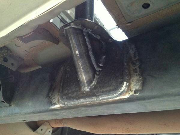

    :spy:
    6843e670c2f197d14d72b9fa27f5d5df_47ee765e2bbca7d6224738baa190d1ec5acaf695.jpg534264e7502c8e335cfeb1b838db38c2_2bdcd4be2bb1c6069c001b512b71c0f20bceb68c.jpg

    ^how do you seal the floor of the cab back up after that?

    Dust boot, like anything else that enters the cabin
    When I did my old truck, I used a mudflap with a slit and trimmed to fit the rollbar.

    Actually he just took the chunk of floor he cut out and split it and then cut a hole in it so it just wrapped around the tube and welded it back in
