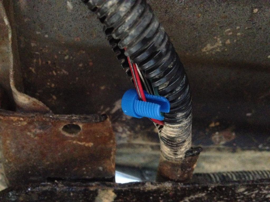

    When installing a reverse camera through the head unit, where is the reverse lamp harness that I splice into with the wire from the head unit?

    By the tail lights..only harness back there.

    Yep. That said, this thing will climb hills all day long in 4Lo/1st gear

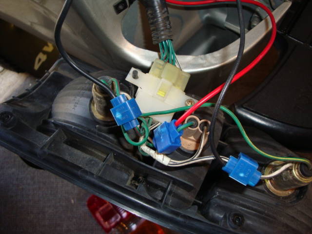

    The power going to reverse was this one for me:
    It was black and red.

    That's the wire color at the taillight.

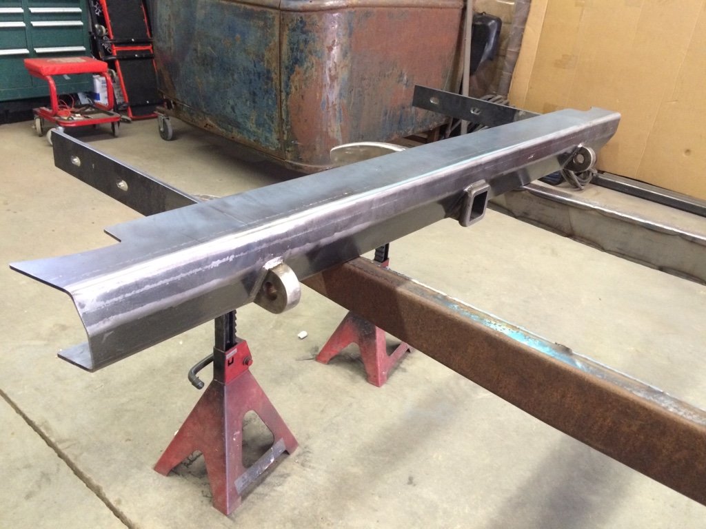

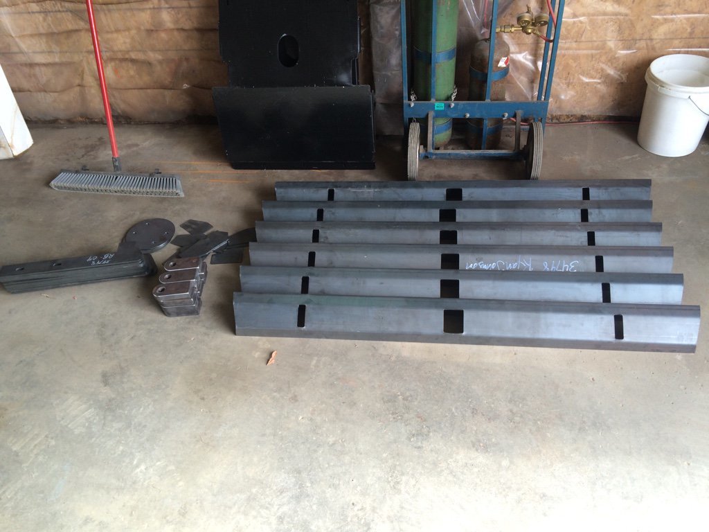

    If anyone wants a DIY weld rear bumper I have a few ready to go. 2 of them have a hole for a tire carrier spindle on the right side, 2 don't. It will look the pic below, but with end caps. No wrap around has been designed for these yet, so if you want that it's all you. $275 plus shipping for the 9 pieces needed. If you also need the 2" square tube to tie in the hitch to the mounting brackets, that is $15 extra. PM me.
    Main structure is 3/16", the mounting brackets are 3/8", and the shackle mounts are 1" thick.
    I will get more pics when I get this welded and the truck gets here to install on.
