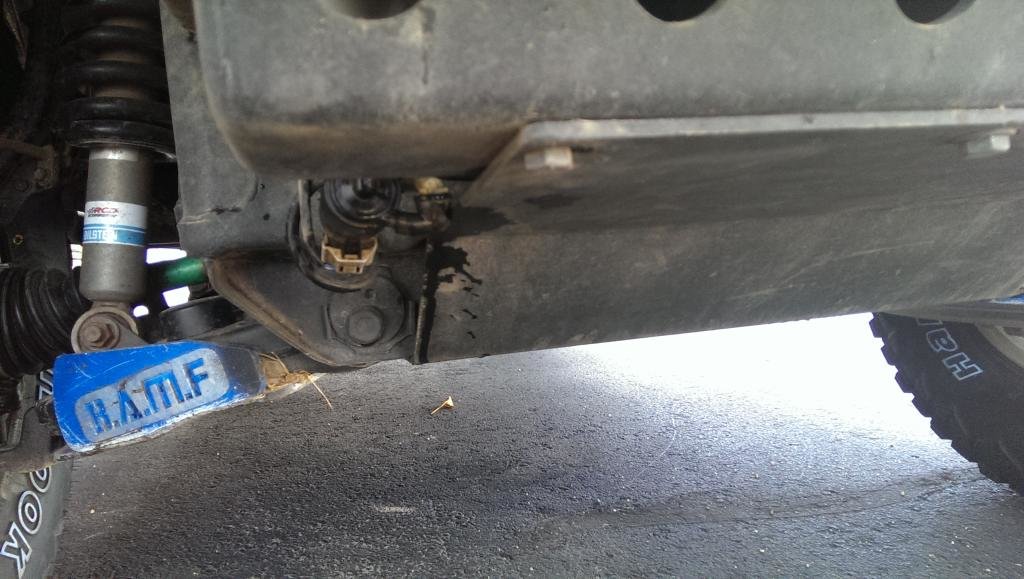

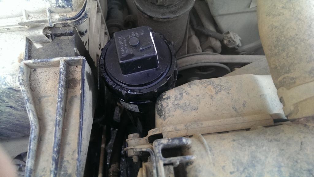

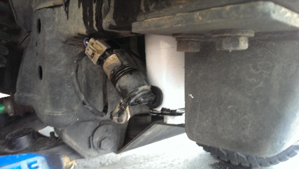

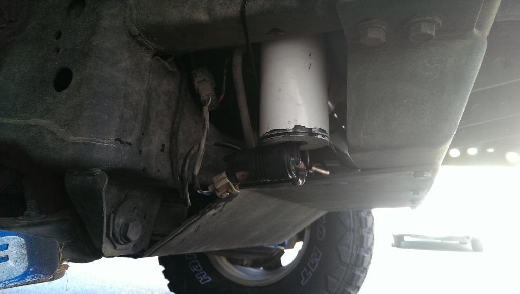

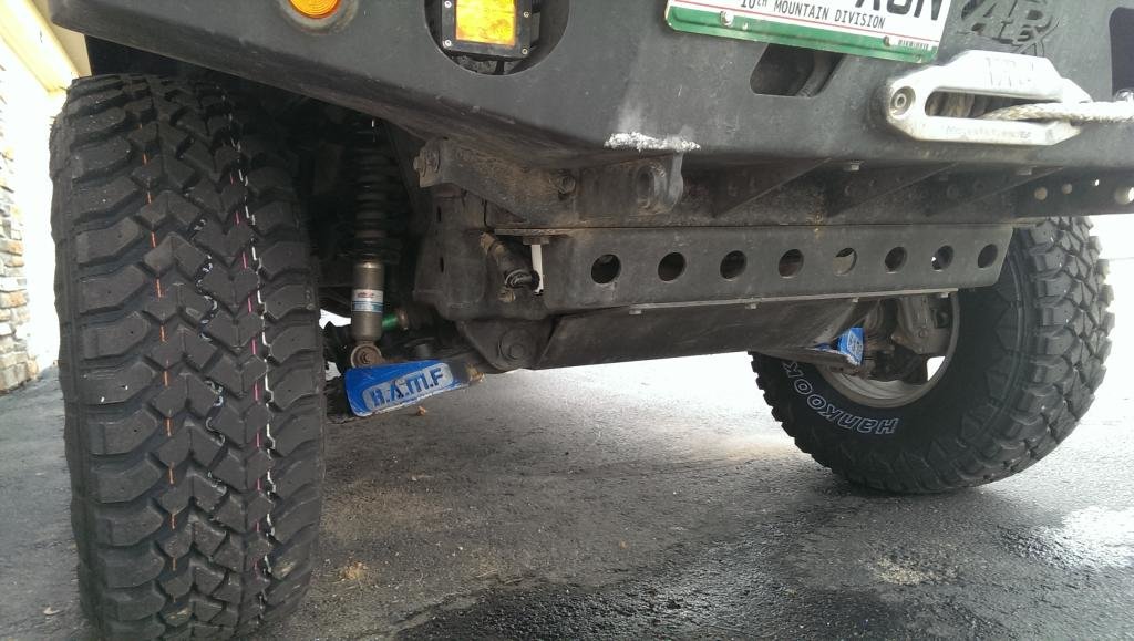

    Did a number of things today. First was do the PVC windshield washer resevoir mod for added tire clearance. Followed Monte's writeup and used a T fitting. Got in all assembeld and installed before I realized it wouldn't really work with my All Pro skids. Pump just hangs down too low:
    So, I ran to the hardware store to pick up a plug for the bottom, and ended up just drilling a hole in the side:
    Pump is still a little exposed:
    Here's what the top looks like:

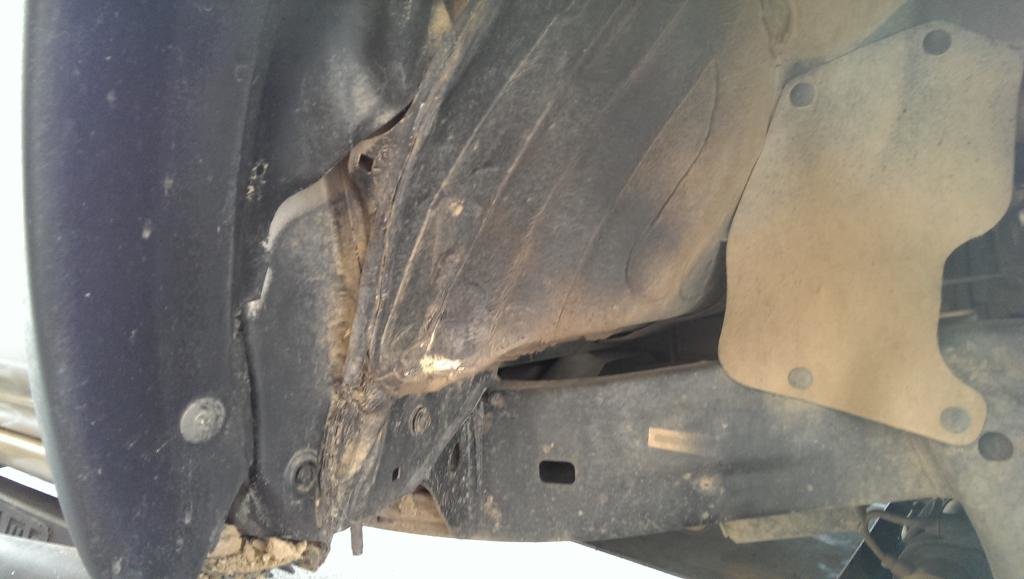

    Next on the list was pounding my fenders back as far as possible. Didn't have much of any rubbing with my 255/85s, but I though it would be prudent with the new tires.

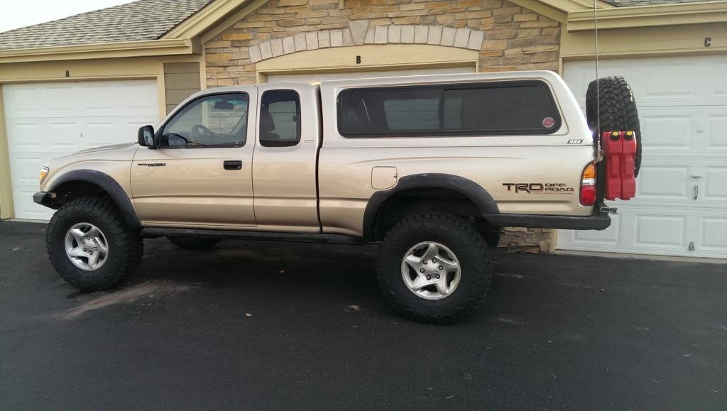

    Truck's looking pretty good with the new 295/75/16 Dynapro MTs and a fresh coat of wax:

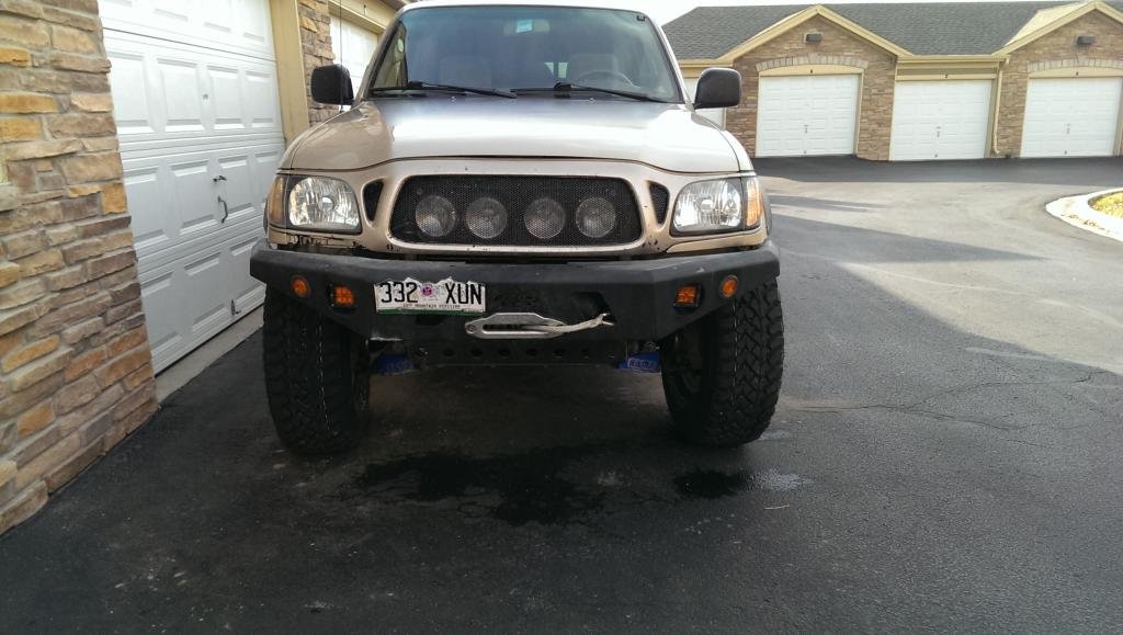

    And then I spent some time restoring the headlights with a 3M kit:

    Her is how I did my windshield res. Very simple and you can see when it is low on fluid..

    Everytime I look at that space I think air compressor. But I guess we'll see how my PVC one holds up. That also reminds me I had to ditch the low fluid sensor, didn't see a way to make it work.

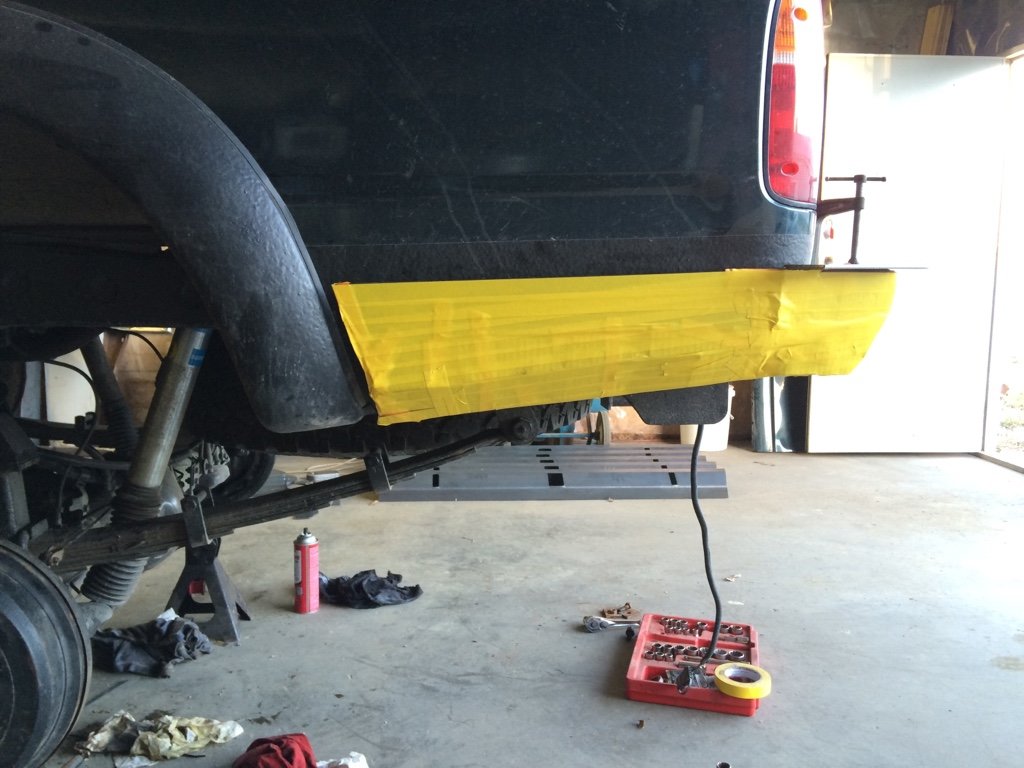

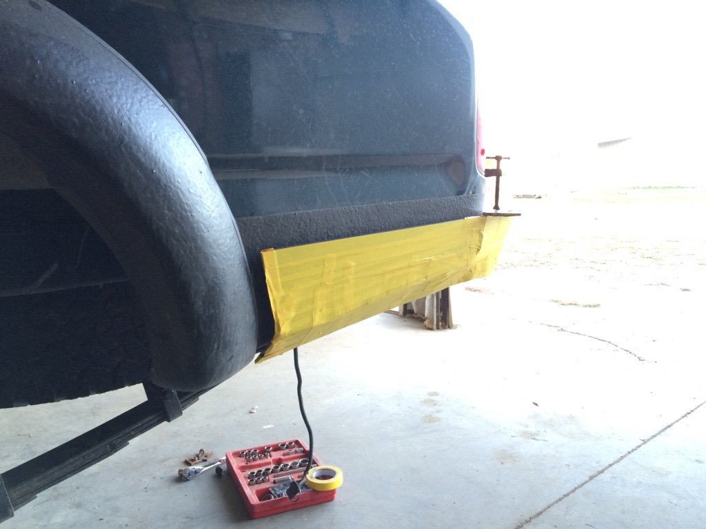

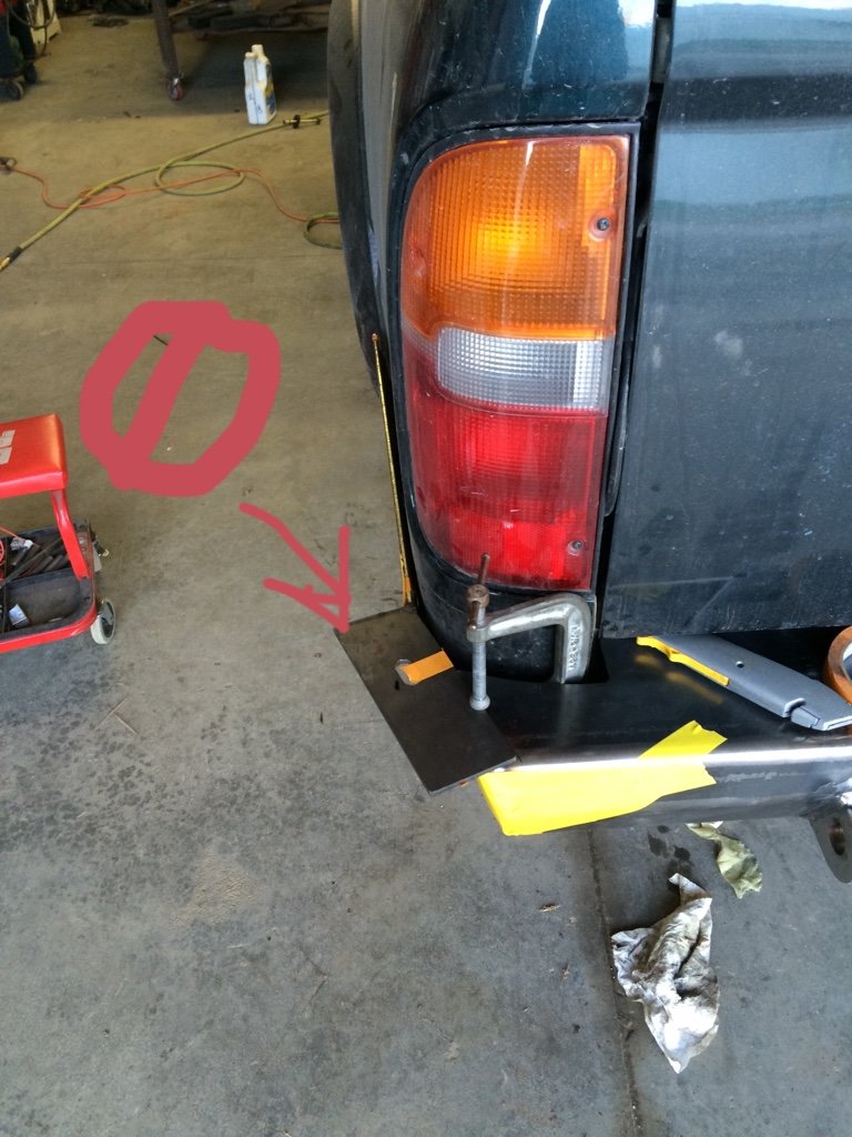

    Designed the plate wrap around.

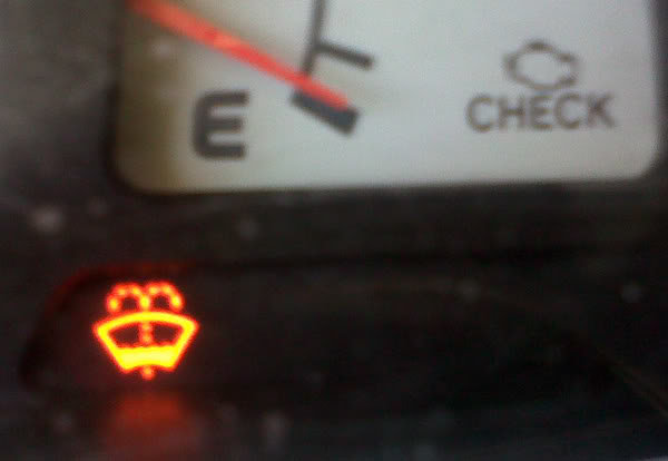

    Mine does. Freaked me out the first time it came on, because I was like wtf is that?!
    Looks like this:
    I'm not sure if certain packages came with it or what, but seems like not all of them have it. Heck our 2002 Tundra doesn't have one either.

    Mine has it but has never come on and not cel or anything after I cut it off.

    I'm no expert, but I'm pretty sure that tape and cardboard won't hold up to trail damage. :confused:

    There's some 1/4" steel in there too. :)

    This is how I did mine as well, even used the stock pump and wiring and low fluid sensor. downside to it is you go thru it much faster than the stock res. but oh well. much better than hanging down!

    What is that res out of??
