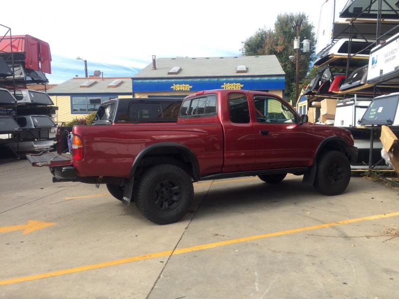

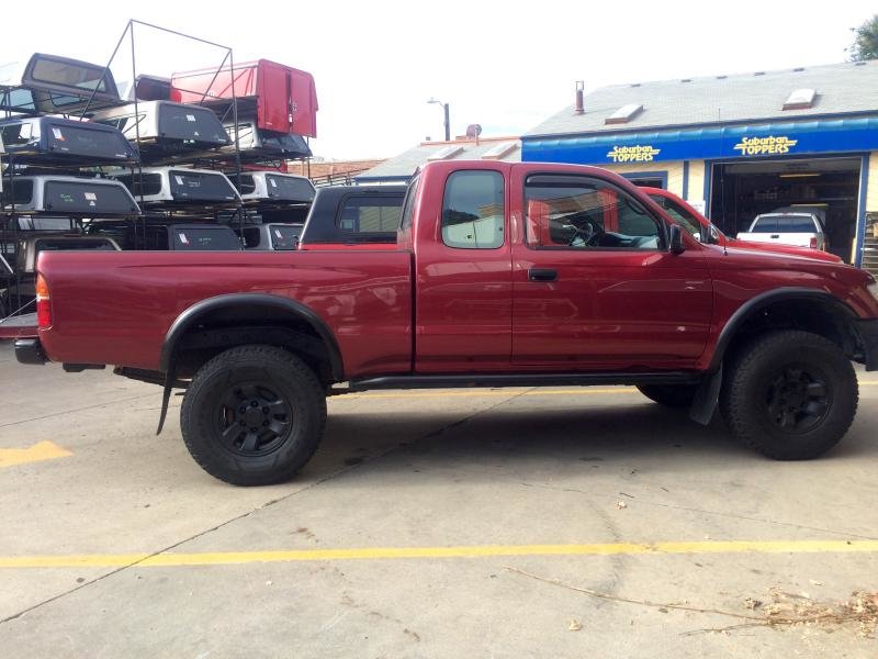

    Took it down to the topper place to have them reinstall it properly this time. First time with the lift and no topper on... figured it's a great time to picture wh0re.
    Also realized I dislike the stock tail lights even more. Would love a pair of those Spyder Euro ones (black). I think that would complete the look of the truck. But no way I'm spending $200+ on tail lights. Not yet at least.

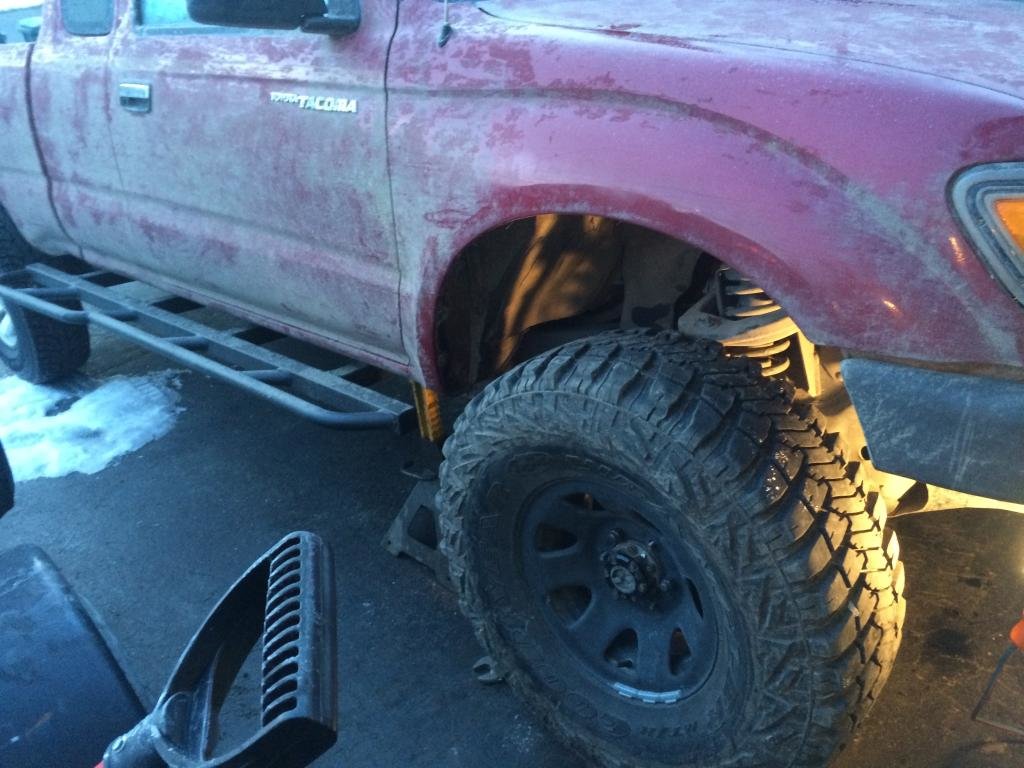

    2008 TRD OR
    Test fit for my MTRs, man they look good.
