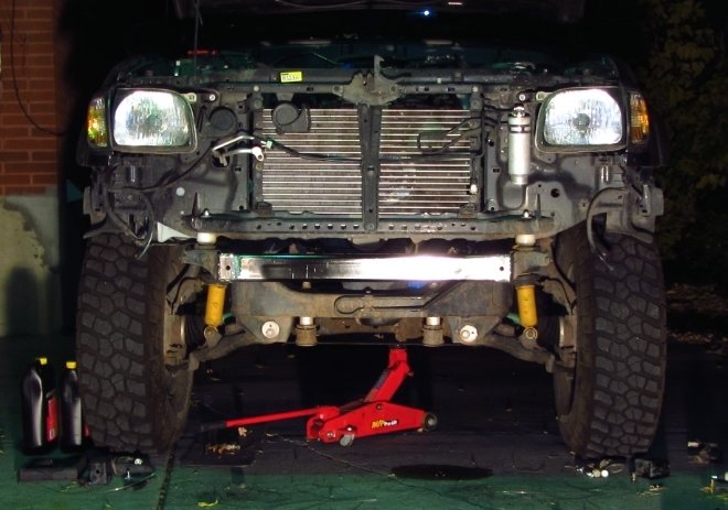

    Done!!!

    :thumbsup: nice! Looks just like mine.. How long did you have the ARB on before you did this? Were the stock end caps all warped?
