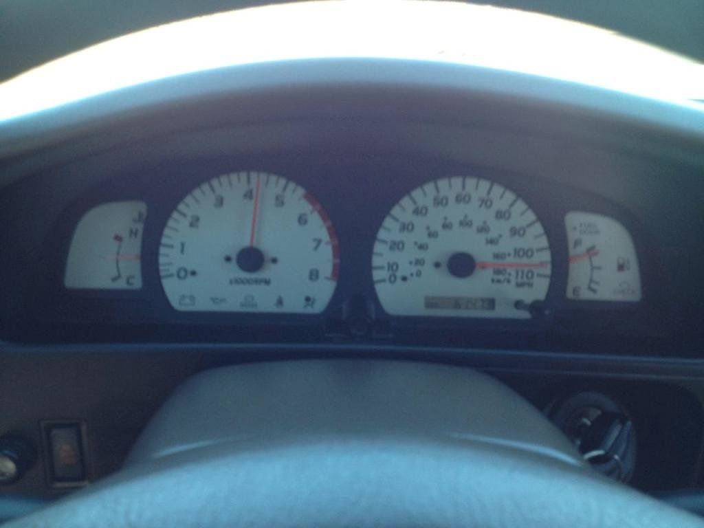

    So some quick math...
    4250 RPM 105 MPH
    3036 RPM 75 MPH
    2631 RPM 65 MPH
    2429 RPM 60 MPH
    That sound about right Jason?
    Can I expect the same approximate results on mine? ie is the gearing different between manual transmissions on the 3.4 and 2.7?

    yes gearing is different between the r150 and the w59.
    R150
    • First Gear: 3.830:1
    • Second Gear: 2.062:1
    • Third Gear: 1.436:1
    • Fourth Gear: 1.00:1
    • Fifth Gear: 0.838:1
    W59
    • First Gear: 3.954:1
    • Second Gear: 2.141:1
    • Third Gear: 1.384:1
    • Fifth Gear: 0.81:1
  4. Oct 29, 2014 at 2:51 PM
    SnowroxKT
    SnowroxKT Well-Known Member
    Dec 11, 2011
    #68604
    5,319
    Kyle
    Anchorage Alaska
    2008 TRD OR
    Thanks Monte!
    So... fifth gear, 4.56, 33" tire.
    W59.........R150...........Speed
    4397 RPM 4250 RPM 105 MPH
    3141 RPM 3035 RPM 75 MPH
    2722 RPM 2631 RPM 65 MPH
    2513 RPM 2429 RPM 60 MPH
    Think this should work until I go with bigger tires. :cool:
