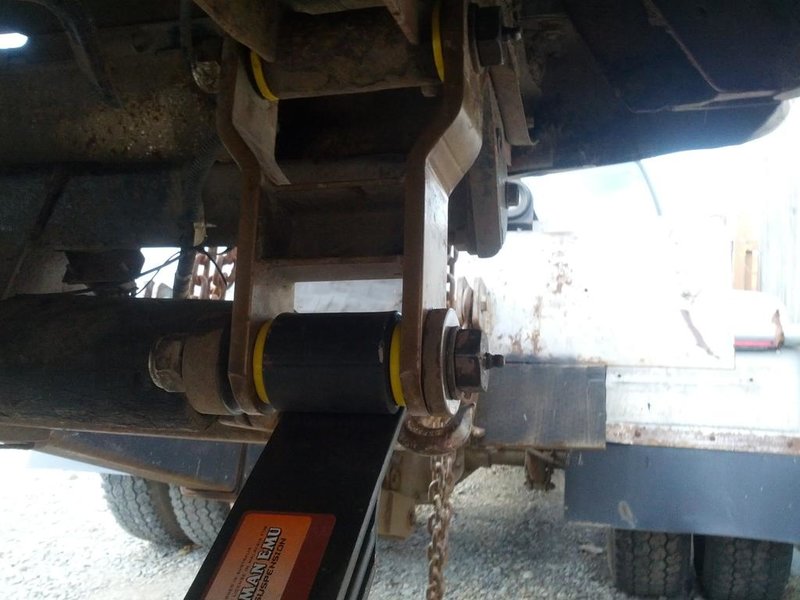

    Modified the rear shackles and packs some today...it works a TON better I'll finish up this week with creeper joints on rear shackle and longer shocks....
    The front has another 2" at shocks of up travel...so I'll split it and drop the mounts 1" down
    Had to find something high enough to hold back end up....new shop has all the lifts at it so running skeleton parts till I open up there...lol
    Use what ya got.

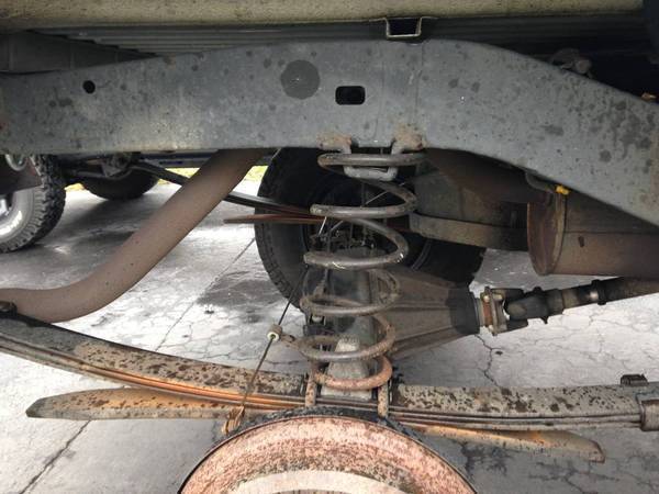

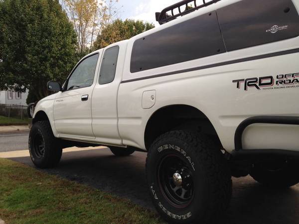

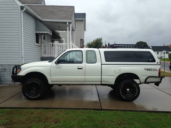

    Added new 5100's to the rear to match the fronts, also installed a Temporary ZUK mod spring instead of a AAL untill I can get my hands on a Dakar leaf pack, Gained a good 2inch back there! Also installed new LED Bar to the front.

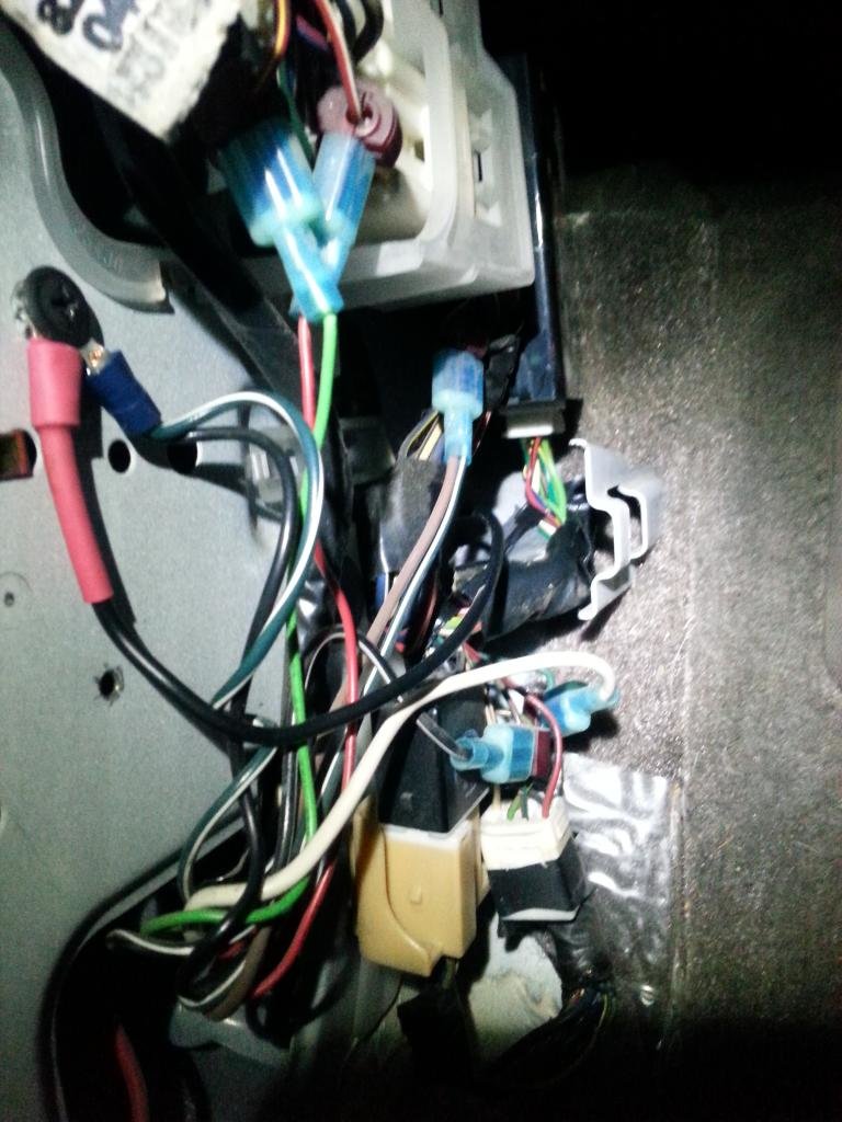

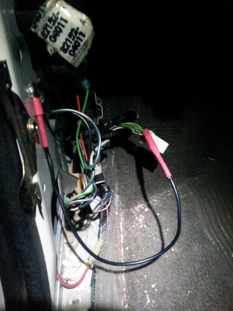

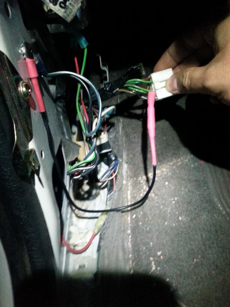

    Anyone hooked up a OTRATTW switch with the dimmer? What wires did you tap into for the light?

    I tapped into the ash tray light.

    Does it dim with the rest of you dash?

    Oh I didn't read that. Sorry. That's actually a good question. I don't have a dimming switch from them, and my ash tray bulb is removed. So I don't know if that wire is "dimmable". But the shifter indicator light does dim, so that could be another source. My switch is just a basic switch with a backlight.

    I figured it out, I had my ground wrong.

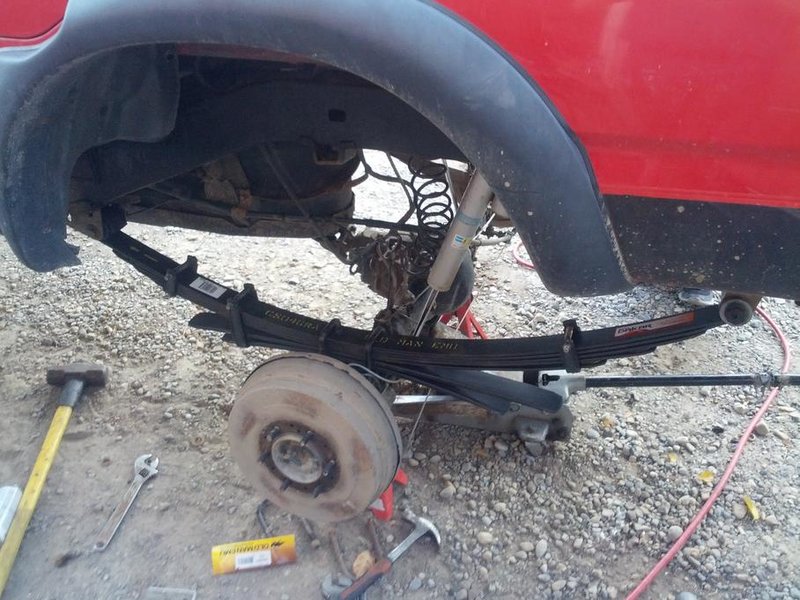

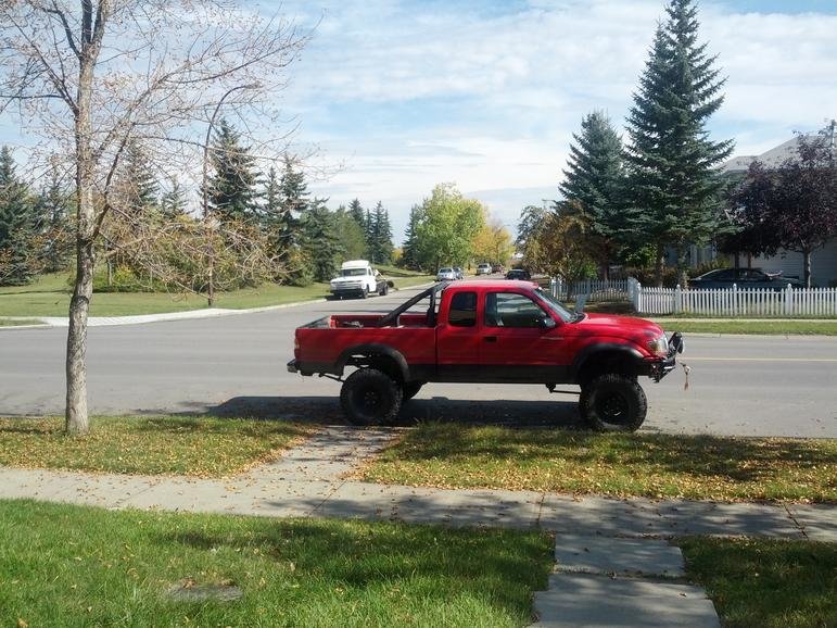

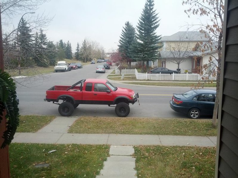

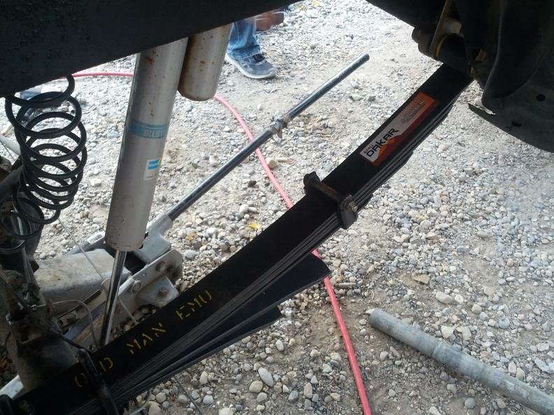

    from a sagging loose rear suspension to as new OME Dakar rear leafs..no more rattles, shakes or noises..ahhhh, before and after pic on road.

    Not 100% sure, but I think Toyota dims on the ground side rather than the positive. I say this because I hooked my OTRATTW switches to the stereo light circuit on the stereo harness and they don't dim. I grounded them through the relay harness for the item the switch controls.

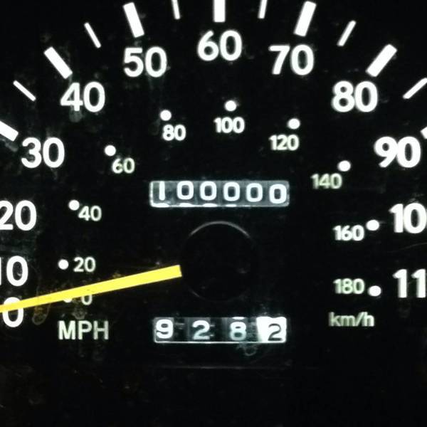

    Finally in the 100k club

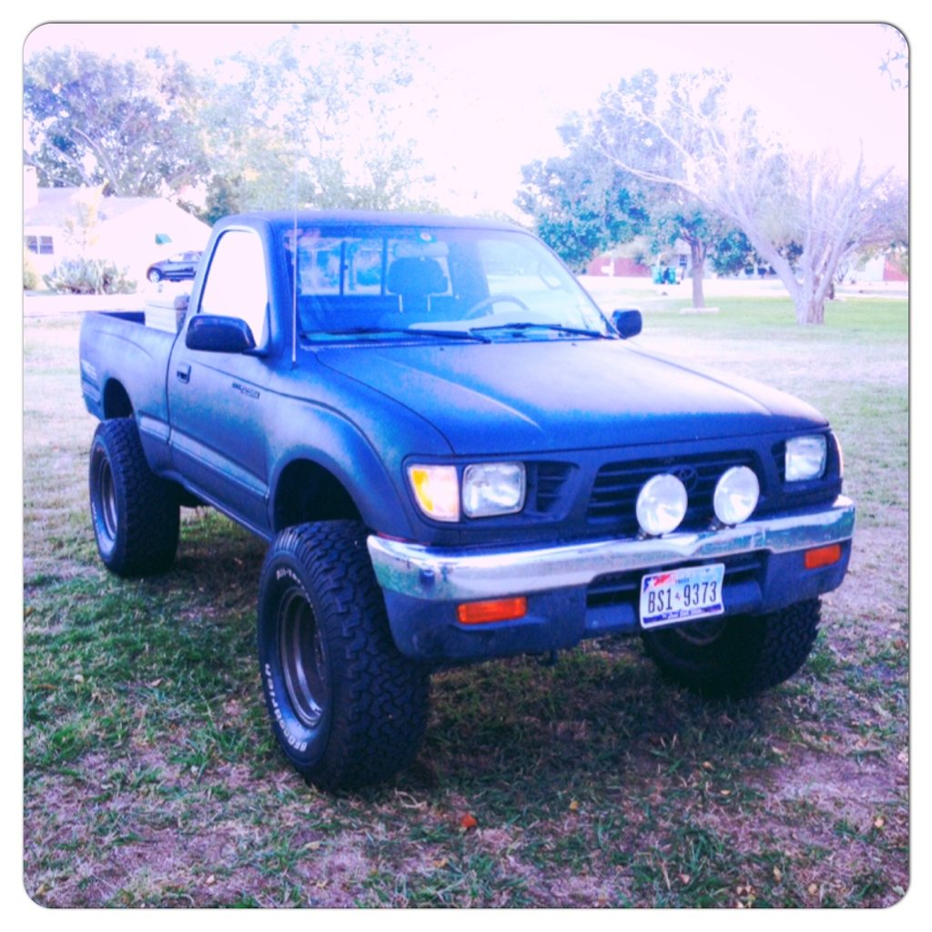

    Got some new shoes and blacked out the grill.....
